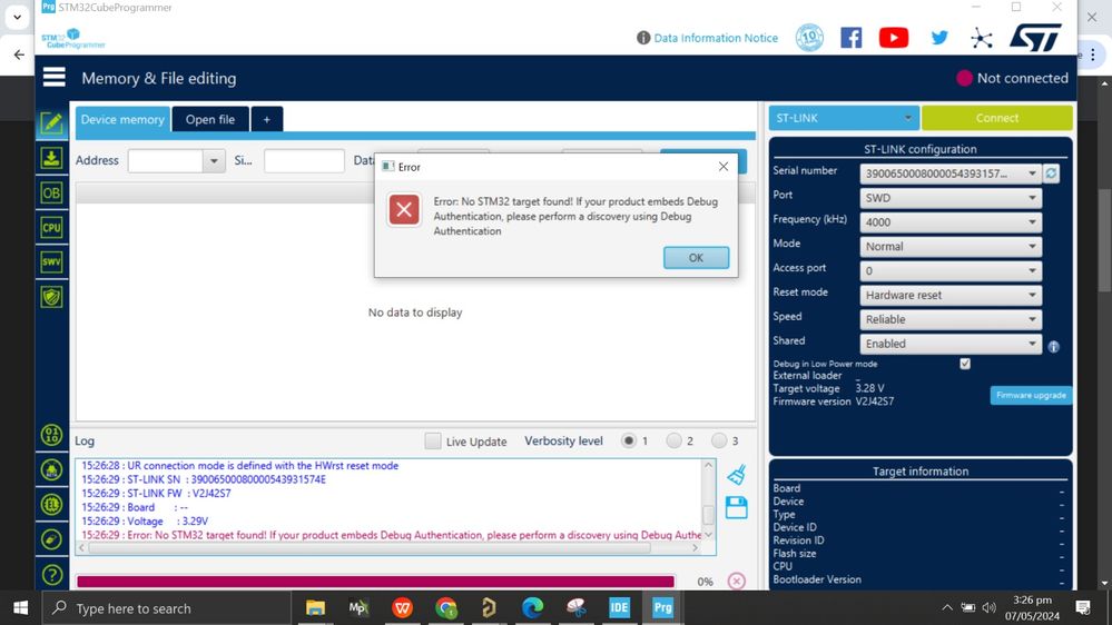

stlink not connect with the programmer after uploading on cube ide
‎2024-05-07 4:10 AM
firstly we connect stlink v2 debugger to the cube programmer later it connect and i get the blue led that show the connection ..after i make all the thing on stm32cube ide and debug according to the video of PHILL LAB after that neither program upload nor it connect to the programmer.
cube programmer show stlink not connected where as it show accurate voltage.

but this firmware and programmer was working fine until i tried to upload the code via stm cube ide i think i have changed any setting from there
‎2024-05-08 12:08 AM
checked it too didnot work i connect external vcc and connect only 3 wire like you said still standing on the same point.
‎2024-05-08 12:13 AM
How code you uplaod??? Work upload in IDE??? Have you other stlink for example on Nucleo board???

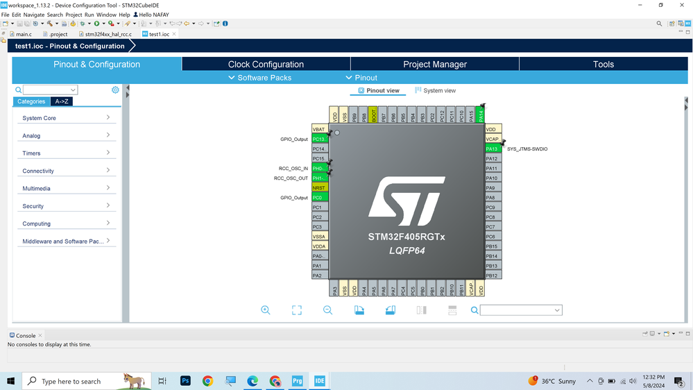

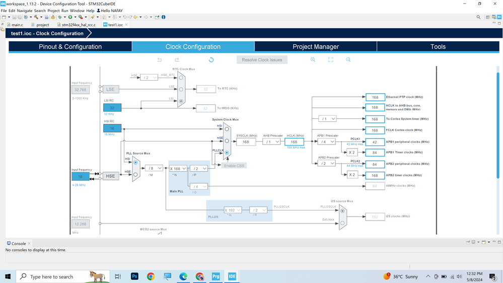

firstly i connect my stm to the computer using the cube programmer it connects (stm32 is fitted on a tqfp 64 pins board) then i use stm ide taking guide from a phillips lab video i set my pin out config (gpio pin as a out and enable predefined pins like crystal and serial wire(dio and clk) then do some clock setting set it to the 16mhz (external ) and upload the generated code while uplaoding it ask me about debugger do some setting there after that my stm32 stops connecting with the programmer

let me show you each step i did there any suggestion will be beneficial for me from you side:
Firstly i enable some pins one gpio to get a output, swdio , swclk, 2 pins for oscillator and set the clock setting

Primary you need stlink with RST support. Secondary correct schematics NRST pin capacitor remove...
When you have this connected right, use Under reset mode in programmer.
‎2024-05-08 1:09 AM
what do u mean by stlink with reset support ? cant i do just connect my nrst to the pin1 reset ? if not so is their any suggestion? secondly i have removed the capacitor from the nrst pin also now nrst is directly connected with the pin no resistor and capacitor used
‎2024-05-08 1:22 AM
Your PIN1 is RST for STM8 not STM32
