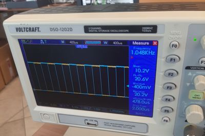

The first time I set the frequency and call the positive quadrature function I get the wanted phase shift; but when I call the function to set the frequency and call the positive quadrature function once again I get negative phase shifting, if I call the negative quadrature function I get positive quadrature instead; so they basically switch.
I've checked that the negative quadrature function doesn't get called.
Edit: If I change Frequency, only once, and call the positive quadrature twice i get positive and then negative quadrature.
Is there any workaround?

EmbeddedPepe
This is how the waveform looks like when I  change frequency after calling positive Quadrature function (the frequency becomes half as well)
EmbeddedPepe
Fixed by setting the mode to the previous one (PWM1) when the frequency function get called.
