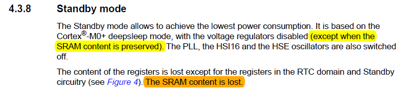

There are conflicting things written in STM32 documentation regarding SRAM retention during Standby mode with SRM32 G0 MCU.
For example, in RM0454 G0 Reference Manual it states two different things 1 paragraph apart

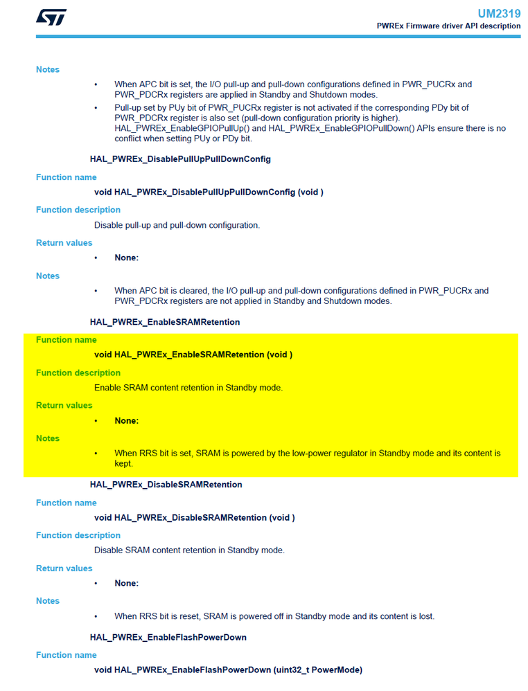

The UM2319 G0 HAL/LL Manual has a function which states that it controls SRAM retention during standby functionality:

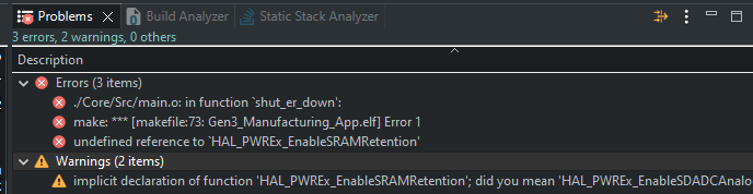

But when I try to compile...

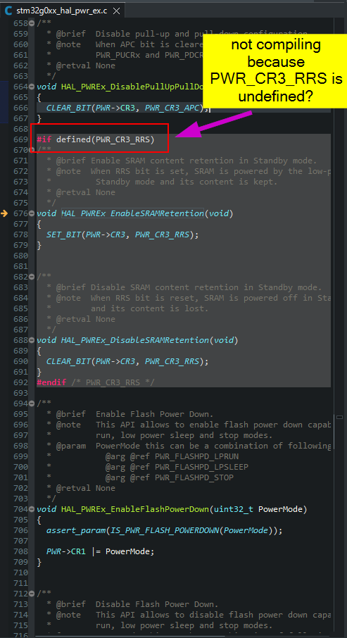

Looking at the contents of `stm32g0xx_hal_pwr_ex.c` I see that the function I'm trying to access is being excluded from compilation by the pre-processor because the RRS bit is not defined:

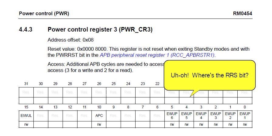

Looking at the RM0454 G0 Reference Manual again, I see that there is no RRS bit specified in PWR_CR3!

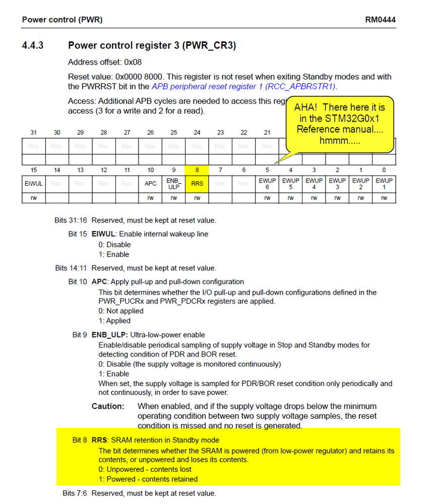

A quick google search seems to indicate it's bit 8 that is defined in some header files out there. These header files seemed to be from stm32g03x1 series controllers.... looking at RM0444 G0x1 Reference Manual the plot thickens:
It would seem the G0x1 "Access" line of micros has this bit defined in its manual but the G0x0 "Value line" data sheet doesn't?
Is that intentional? Is the G0x0 "Value line" microcontroller able to retain its SRAM in standby mode???

Added this define to stm32g030xx.h` to get the sram retention HAL function to compile
#define PWR_CR3_RRS_Pos (8U)
#define PWR_CR3_RRS_Msk (0x1UL << PWR_CR3_RRS_Pos)
#define PWR_CR3_RRS PWR_CR3_RRS_Msk

Using the above program with my STM32G030F6, I was able to confirm that YES INDEED, there is an undocumented RSS bit (bit 8) in PWR_CR3 register that controls SRAM retention during standby mode for STM32G0x0 Value Line MCU's.
I think we need a new G0x0 Reference Manual with the correct doucmentation on the PWR_CR3 register!!!
