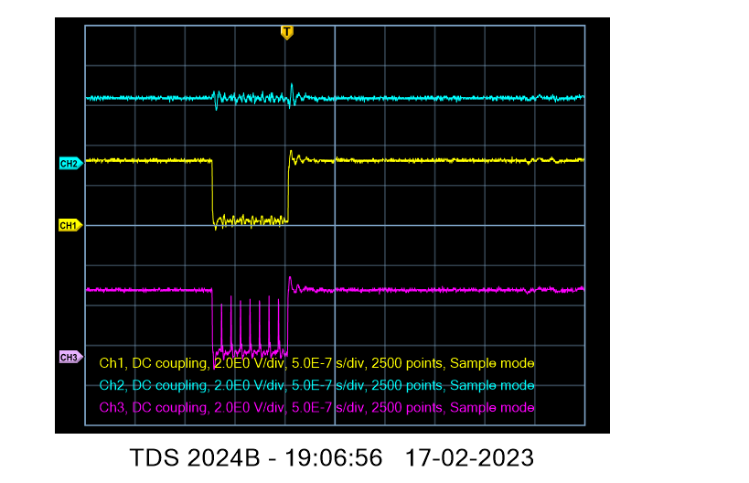

I'm trying to communicate with SRAM device on my board.
I'm using STM32H747XIH6 MCU.
I tried to capture the Write enable, chip select and output enable pins on the board but I saw an unusual response of the output enable.

The captured waveform is attached belowBlue : Write Enable
Yellow : Chip Select
Pink : Output enable.
I do not understand why does the output enable toggle multiple times for one write/read operation.

2023-02-17 11:28 PM
Cortex-M7 are complex. Do some background reading.
How is this area defined in MPU?
Reads to Cacheable areas result in cache line fill, read to non-cacheable but Normal areas are subject to speculative prefetch.
