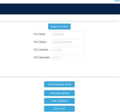

have you clicked on the button. ’Start wireless stack’ before uploading your up. If the stack and FUS are very well working, I think you should create new thread (after selecting a best answer for the stack donwlaod issue) where you give a full description on the zephyr application you are using and how it behaves.

Hello @Lee_T and welcome to the ST Community.
Could you please provide the bin file for the FUS that you have used together with the STM32CubeWB version. If you have downloaded the New FUS version v2.0.0, you have to be aware that:
- Warning 1: With FUS v2.0.0, Coprocessor Binaries can be installed only through the USB interface,
Currently CubeProgrammer versions do not support “FW_delete” command when using the ST-Link interface. The next CubeProgrammer release will address this limitation. - Warning 2: For Coprocessor Binaries marked as “FUS_v2 only” in the Wireless Coprocessor Binary Table below, the “start address” provided by CubeProgrammer under “Firmware upgrade services” must be corrected as follows: start_address = (start_address - 0x4000). However addresses provided in the table are correct.
If you are using the FUS V1.2 and the stm32wb5x_BLE_Stack_full_fw.bin from the STM32CubeWB V1.22.1, be aware that the stm32wb5x_BLE_Stack_full_fw.bin from the STM32CubeWB V1.22.1 is compatible only with the new FUS version 2.0.0.
If all that is working fine, try to click on the "Start Wireless Stack" button on the STM32CubeProgrammer after successfully uploading the FUS and Stack.
Best Regards.

I'm using FS version 2.0.0.3 and STMCubeProgrammer V2.19.0. The BLE stack gets loaded at 0x080D0000, as shown in the log below. I looked around CubeProgrammer but I didn't see anything marked "Start Wireless Stack".

Hi STTwo-32,
The Nucleo WB55RG board I am using has an onboard STLink, which is connected via a USB connector. Is this the USB connection you are referring to? If not, what USB connection is used and what selection is made on CubeProgrammer?
In addition, I still have not found the "Start Wireless Stack" button in Programmer.
Apologies for all the questions.
Regards,
Lee
2025-06-17 3:16 PM - edited 2025-06-19 6:44 AM
Hello @Lee_T
To understand how to connect in USB DFU mode, please have a look at this video specially the part after 4:50. For the ‘Start Wireless Stack´, you can find it as you can see on this screenshot:
Best Regards,
STTwo-32
