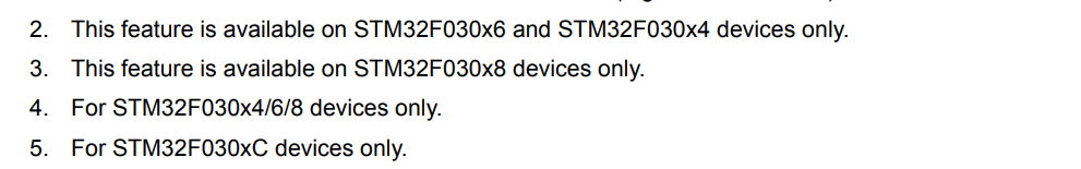

It works fine if I use PA9, but using PA2 I get nothing - the GPIO is floating. Has anyone managed it and, if so, is there a trick I'm missing?

Are you sure is your mcu F4?
KnarfB
are you sure that TX_Pin is LL_GPIO_PIN_2?
my CubeMX sets GPIO_InitStruct.Speed = LL_GPIO_SPEED_FREQ_HIGH;
hth
KnarfB
waclawek.jan
Read out and check/post content of USART and relevant GPIO registers.
Make sure physical connection is OK by setting given pin to GPIO output and toggling it.
