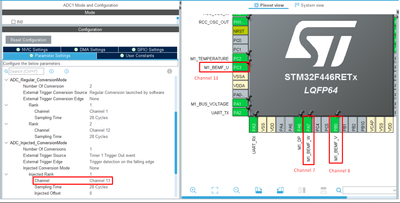

I'm working with the STM32F446RE and exploring the 6-step BLDC motor control example provided by the STM32 Motor Control SDK. In the CubeMX configuration of the firmware:
  • 3 GPIOs are configured as analog inputs:
    • M1_BEMF_U → PC3 → ADC1_IN13
    • M1_BEMF_V → PA7 → ADC1_IN7
    • M1_BEMF_W → PB0 → ADC1_IN8
However, in the ADC Injected Conversion Mode, only Channel 13 (PC3) is selected and used (1 injected conversion configured).
See image below for reference:
My question is:
Why are all 3 BEMF pins configured in CubeMX if only Channel 13 is used in the ADC injected group?
I expected that all 3 channels would be used in the injected sequence to sample U, V, and W BEMF voltages.
Do they dynamically change the injected channel in code depending on the commutation step? Or is there another reason for this configuration?
Thanks in advance for any clarification!
Hi Duc, this specific ADC channel management in CubeMx is currently due to the IOC generation done by the MCSDK WB that set only one injected channel per used ADC. This could be improved in the future. And as you said, at each commutation step, a new BEMF phase signal is checked for zero crossing detection on its specific ADC channel.
Best regards.
Fabrice

Duc
Hi again,
After reviewing the firmware more closely, I believe I’ve found the answer to my own question, and I’d like to confirm if this is correct:
At each step of the 6-step commutation, the firmware dynamically updates the injected ADC channel to match the floating phase (either U, V, or W) — which is the one from which BEMF needs to be sensed.
This is done using the LL_ADC_INJ_SetSequencerRanks() function.
So even though the ADC could be configured for multiple injected conversions, the firmware uses only 1 injected channel per step, and switches it at runtime based on the commutation step.
This seems efficient and makes sense for sensorless control, but I’d appreciate it if someone could confirm this is the intended behavior in the STM32 Motor Control SDK.
Best regards.
Fabrice

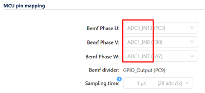

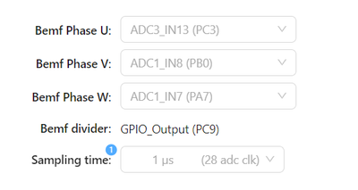

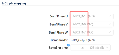

I hope you’re doing well. I wanted to revisit this issue mentioned in the Release Notes for X-Cube-MCSDK 6.4.1, as I came across some additional information that might be relevant. First, I’d like to thank you and your team for addressing this matter.
After upgrading to X-Cube-MCSDK 6.4.1, I noticed that the issue hasn’t been completely resolved. Specifically, when using the hardware Nucleo-F446RE, X-Nucleo-IHM07M1, and motor A2212 13T, I observed the following:
  • Although I am working with the same hardware setup, every time I create a new project, the MCU pin mapping for the BEMF seems to differ, and it is not consistent.

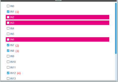

  • While this is not a significant issue for me, the bigger concern is that after generating the project and opening it in CubeMX, I noticed that the setup for the 1-channel ADC is missing. Here's an example:
My question is whether the missing ADC channel setup could affect the overall functionality of the 6-step BLDC motor control code. I ask because I noticed that the 6-step firmware uses Analog Watchdog Mode to monitor the BEMF and check if it crosses Vdc/2.
Looking forward to hearing your thoughts on this.
