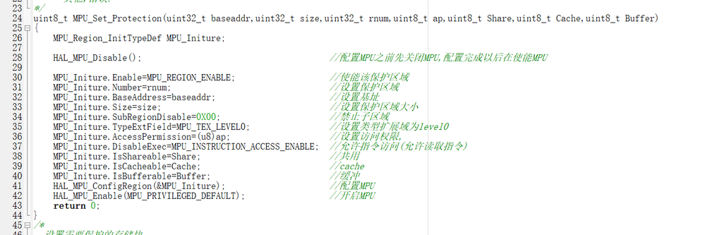

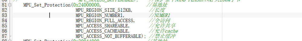

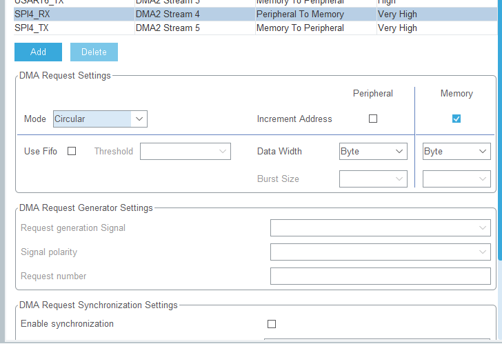

the below is my configure! can you help me which sides is wrong!
the ​above image is mpu set.
​and the below image is dma set.
and I use USART can tranmit and receive data is correct! so I think the cache is configure suitably.
the ram address is 0x24000000.
