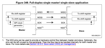

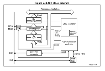

Notice that your two diagrams present different answers to my question.
In Figure 349, the slave has a "Tx shift register" and an "Rx shift register".  In this scenario, once a byte has been written into the Rx shift register and sent out over MISO, there will be nothing left in the Rx shift register and it will send zeroes on subsequent clock cycles.  That's not what's happening so this figure is not accurate for the STM32.
In Figure 348, there is a single "Shift register" and it pulls data out of a "Tx FIFO" and into the Shift register so it has something to send over MISO.  This fits with what I'm seeing, if the STM32 simply recycles the contents of the Tx FIFO instead of clearing it out.   That makes sense, the designers of the STM32 had two choices:
1) When the Tx FIFO is empty, send zeroes
2) Don't check whether the Tx FIFO is empty or not, just send the next byte
Option 2 is less silicon so probably a better choice.
So for my program, if I write a 0x00 into pspi->Instance->DR every time I don't have something else to send, it seems like that will zero out the Tx FIFO so the STM32 will not send old bytes.
For anyone looking at this post in the future - writing extra zeroes into pspi->Instance->DR doesn't work.
The documentation for the STM32G4 says it's got "Two 32-bit embedded Rx and Tx FIFOs with DMA capability" (I think they should replace "two" with "separate" in that sentence).  Anyway, the definition for DR in stm32g474xx.h is "__IO uint32_t DR;" but the documentation shows that the DR register is only 16-bit.
So as a test, instead of the slave just writing one byte into DR when it got a register read request, I had it write "0xFFFFFF00 | outValue", and what I saw was this (I'm obviously guessing at the contents of the 32-bit TxFIFO):
MOSI0x0B0x000x000x0B0x010x000x0B0x020x00
Tx FIFO0x000000000x00000000Write 0xFFAD, get 0x0000FFAD0xAD0000FF0xFFAD0000Write 0xFF1D, get 0xFFADFF1D0x1DFFADFF0xFF1DFFADWrite 0xFFF2, get 0xFF1DFFF2
MISO0x000x000xAD0xFF0x000x1D0xFF0xAD0xF2
Bottom line - it looks like the STM32 is doing a rotate right on the contents of the FIFO, where I would prefer it do a shift right, but there's no option for controlling that.
