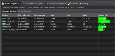

I am currently using a FreeRTOS example project with the stmwL55, but instead of the defaulted heap 4, I am selected heap 5 in the ioc to utilize RAM2 for the 28kb. I have used the suggested example of how to initialize the heap before task creation.
HeapRegion_t xHeapRegions[] =
    	{ ( uint8_t * ) 0x20000000UL, 32768 }, //<< Defines a block of 0x8000 bytes starting at address 0x20000000
    	{ ( uint8_t * ) 0x20009000UL, 20480 }, //<< Defines a block of 0x4000 bytes starting at address of 0x20009000
   	{ NULL, 0 }                //<< Terminates the array.
However, the program hard faults when the program gets to prvPortStartFirstTask(). The build analyzer shows that my RAM1 only has 50% usage and RAM2 is at 0% so I am not sure what else I have to do for my memory to actually be used.
5 REPLIES 5
Pavel A.
Where is your main (aka interrupt) stack? Data, BSS memory? Is by chance the address 0x20000000 collide with these?

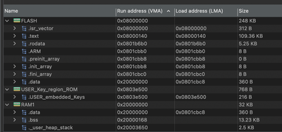

Hey Patrice,
I looked at table 3 and was wondering where I would check if the sram is set to execute never. I am also still confused as to why ram1 is not used when I defined space for in the heap structure.
Thanks
 This is the memory details. however even if I have the starting address as 0x20003650, The build analyser still does not show the change ram1 in usage and I do not know how use ram2 for usage. Is there a function for enabling ram2 or is there something else I'm doing wrong?
So your .data begins from 0x20000000 and at the same address you place the heap. Seriously?
