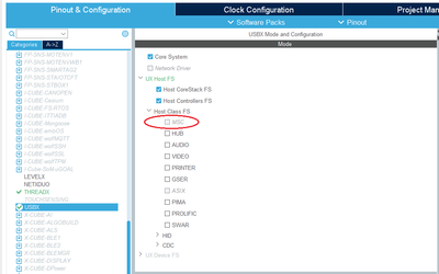

I observed that in CUBEMX, under "USBX Mode and Configuration"->"UX Host FS"->"Host Class FS"->"MSC" is disabled.
I am testing using the NUCLEO-U545RE-Q and intend to use the same IC with production boards to be interchangeable with F105/F405.

Hi @NFern.1
This is because you need to enable FileX in CubeMX.
Best regards,
FBL
NFern.1
Thanks @FBL , on enabling FileX in CubeMX the Host Class FS -> MSC option is now enabled.
