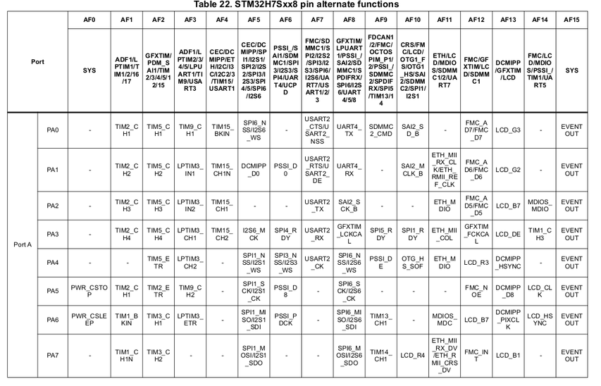

I am using an STM32H7RSxx device and I need to use the SPI6 (both full and half duplex) with the DMA.
The problem I am facing on is the MOSI pin doesn't transmit anything.Only the SCK is working.
Despite having configured it for SPI6 Alternate Function (according to datasheet)
  // SPI6 pins
  // SCLK, MISO, MISO, NSS
  GPIO_InitStruct.Pin = LL_GPIO_PIN_4 | LL_GPIO_PIN_5 | LL_GPIO_PIN_6 | LL_GPIO_PIN_7;
  GPIO_InitStruct.Mode = LL_GPIO_MODE_ALTERNATE;
  GPIO_InitStruct.Speed = LL_GPIO_SPEED_FREQ_VERY_HIGH;
  GPIO_InitStruct.OutputType = LL_GPIO_OUTPUT_PUSHPULL;
  GPIO_InitStruct.Pull = LL_GPIO_PULL_UP;
  GPIO_InitStruct.Alternate = LL_GPIO_AF_8;
  LL_GPIO_Init(GPIOA, &GPIO_InitStruct);
it always stays to low level.

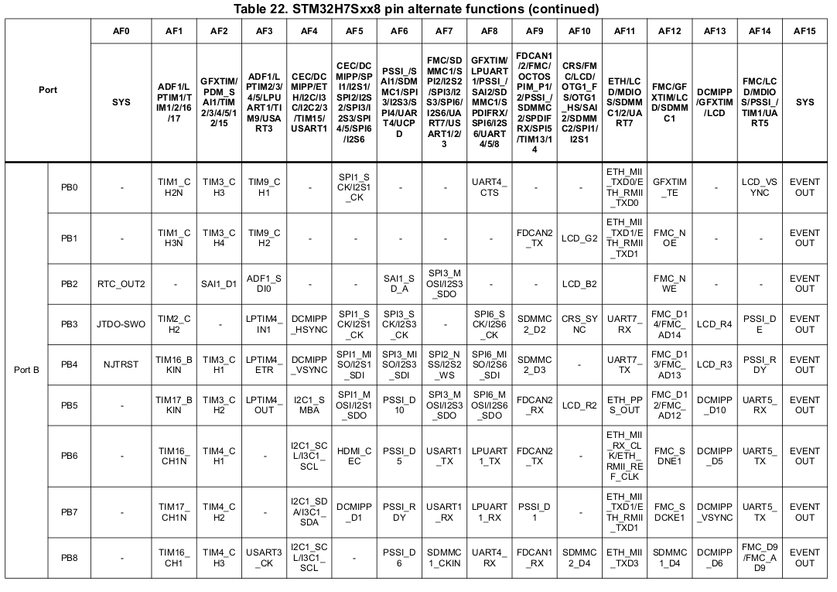

What is strange is the fact that if I use PB5 as SPI6 MOSI
I can see as the pin stays at high level in idle state, but low for the rest of transmission, and this is quiet confusing.
If I am not blind at all, the TRM and datasheet does not say anything about it..

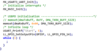

Can you post code that has data cache disabled, uses the SPI, and exhibits the behavior you describe in the OP?
Here it is attached.
Basically,
  1. SCB_EnableDCache() is executed in Boot/Src/main.c otherwise the FW does not run at all. Despite all test I have to debug where the FW stalls in this case.. This is a situation on trial and error, which I hate the most.
  2. SCB_EnableDCache() is not executed in Appli/Src/main.c. Executing SCB_DisableDCache() instead does not change the behavior.
  3. In MPU_Config() from Boot/Src/main.c, I set MPU_InitStruct.IsCacheable = MPU_ACCESS_NOT_CACHEABLE for MPU_InitStruct.BaseAddress = 0x70000000 (running Appli from external QSPI - this is a NUCLEO-H7S3L8 board.
I understand that cache should not be used at all, right?
