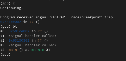

0693W00000QKmsKQAT.pngThis sequence is press button > sitgtrap pauses gdb > backtrace shows the above. Looks like it calls my ISR, but then there's an unknown error handler in there afterwards?

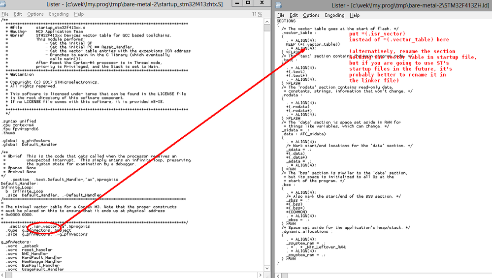

waclawek.jan
Indeed.
To see, which section is located where, it's useful to have the linker to generate a so called mapfile during linking, add this into makefile:
LFLAGS += -Wl,-Map=$(TARGET).map,--cref
I also don't like the gdb's built-in disassembler, I have this rule in makefile:
lss: $(TARGET).lss
# Create extended listing file from ELF output file.
%.lss: %.elf
	@echo Generating $@ ...
	$(OD) -h  $< > $@
	$(OD) -d -z -j .isr_vector  $< >> $@
	$(OD) -S  $< >> $@
(note that this explicitly uses the vector table section name, for a reason...)
so then when needed, I generate the list/disasm file simply by typing 'makefile lss' and then I can browse it as any textfile.

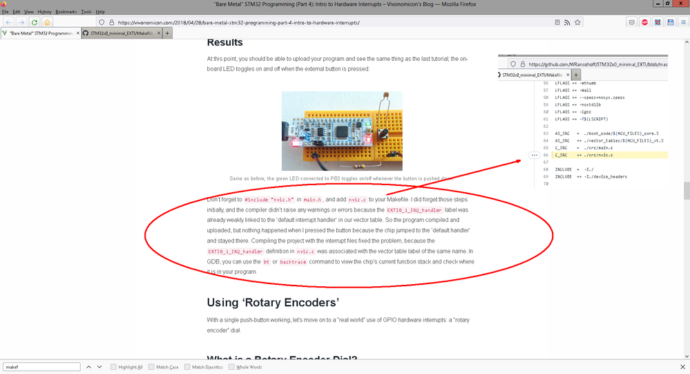

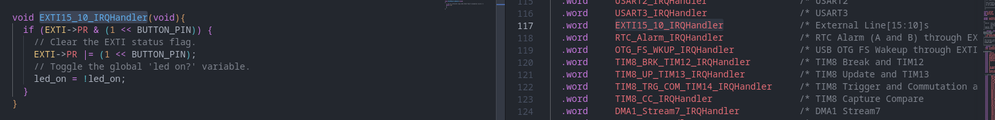

Check whether the IRQ handler name actually corresponds to the one in the vector table.

You don't compile/link nvic.c. Add it to the sources in makefile.

I definitely saw the matching of the names being an issue, so I did check that, but they line up, so it's something else :(

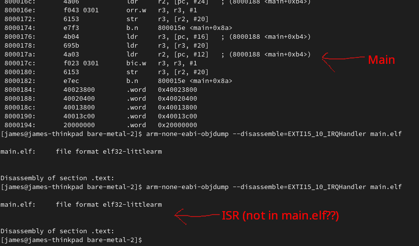

EDIT:
While poking around in the assembly to see if my ISR was linking back to the main program properly, I found that the EXTI15_10_IRQHandler function wasn't making it into my main.elf:
0693W00000QKngoQAD.pngI'm guessing this has something to do with my linking/including errors you mentioned, is that right?

But as described there, as long as you don't explicitly define an ISR function in your code, the "weak" definition will prevail, and that leads to DefaultHandler which is an infinite loop. So, I can't explain the SIGTRAP and why the stack went wild (as witnessed by the backtrace in gdb). The binary you provided is also suspicious, does not contain the vector table at its beginning as it should, so you probably messed up the sections and linker file somehow.

Well, seems you've caught me using code without reading it fully... Fixed the issues you found and it works!
Thanks for pointing this out so explicitly, and taking the time to dig through the mess I made.
