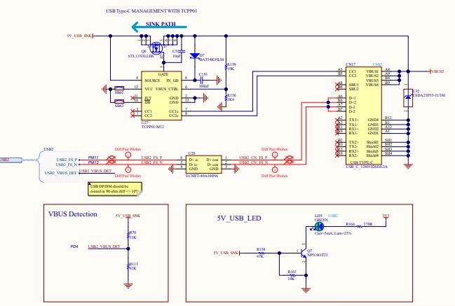

Hi @DStu and welcome to ST community !
The warning is about violating the STM32H7 absolute‑maximum ratings by back‑powering its I/Os via the USB connector when VDD is off from ST Link
> Could you perhaps give us some guidance or a hint on how this should be implemented correctly?
I recommend using USB TypeC connector and TCPP01 protection port. Here is an example.
Best regards,
FBL

While we can address the issue by ensuring that the MCU is always powered when—or before—the PC is powered on, it would still be preferable to add proper protection. Could you perhaps give us some guidance or a hint on how this should be implemented correctly?

FBL
Best regards,
FBL
