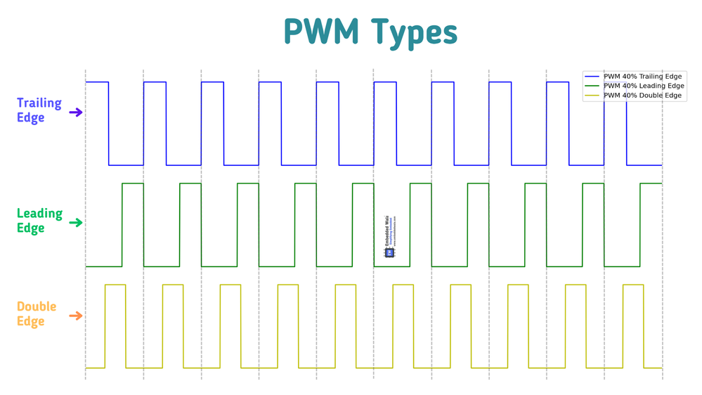

Dear all,
I have a custom pcb with a STM32H753 on it.
There I'm already using the TIM12 function for generating a PWM output signal
This is my init function - generated from CubeMX:

So the normal operation of PWM with a trailing edge is working (see attached image for seeing the waveform).
Now I want to adjust parameters to get - based on same frequency and duty cycle - the leading edge pwm wave form.
What needs to be adjusted on the sConfigOC, or what else needs to be adjusted / manipulated if I switch from trailing edge to leading edge?

‎2024-08-07 1:32 AM
sConfigOC.OCMode = TIM_OCMODE_PWM2;
‎2024-08-07 2:15 AM
Anything else to be considered?
E.g. _PWM[ch].TimHandler->Init.CounterMode = TIM_COUNTERMODE_DOWN;
‎2024-08-07 5:34 AM
I think you need to change the pulse value and the polarity.
sConfigOC.Pulse = 500; sConfigOC.OCPolarity = TIM_OCPOLARITY_LOW;
Your current waveform is 50% duty cycle, so changing the pulse doesn't do much.
