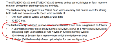

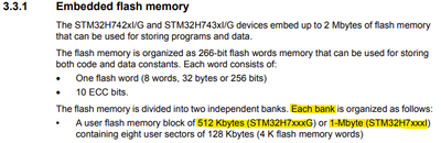

    STM32H743VGxx officially has a hole after 512KB, between bank1 and bank2. But! The hole does not have to exist. This can explain why CubeProgrammer and the debugger behave differently. Officially, your .ld file that does not have the gap after 512KB is wrong for H743xG.

    Divide it to two blocks: 512K in bank1, and 512K in bank2.  You can also use the undocumented space in the gap between the banks, on your own risk.
