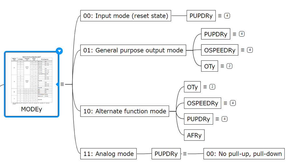

bivin mato
So my question: when using alternate function for a GPIO, does the pullup/pulldown setting matter ? Same question for output type (push-pull / open drain) ? And what settings should be used for SPI pins ? HAL examples from ST set all SPI pins with pull-down and push-pull. Is it correct ?
Find the settings applicability below.
Sorry I don't understand the meaning of this figure.
waclawek.jan
Yes.
Yes.
Whichever fits your application. With SPI, it would be typically push-pull, no pullup/pulldown; but then there are also non-typical applications.
