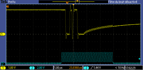

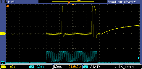

I recorded traces with a scope and I am not able to analyse them. I logged both SCK and MISO, once at slave side, once at master side. So the only difference between both traces is around 10cm of wires (obviously I tried several wires).
Output from Slave. You see that MISO (in yellow) is relatively clean and I checked that the bits are correct.
Input at Master side:
Do you understand the differences between the traces ?
The lower one clearly goes into hi-Z mode before SCK is done. If you're expecting the slave to be driving the signal at that time, it's not. Review the datasheet to see why.
This isn't a clock or pullup/down issue. The problem is the slave is not driving the line during the entire communication. Probably because it thinks it isn't supposed to, or is finished sending, or something.
But the trace recorded at slave side is showing a clean signal isn't it ? Isn't it strange ?
For the trace you recorded, yes. You're not saying these two are the same exact signal recorded simultaneously at different locations on the wire, are you? I would not believe that.
Simultaneously no. I hadn't enough probes to do so. However I recorded several times at each location on the wire and I had every time the exact same trace.
