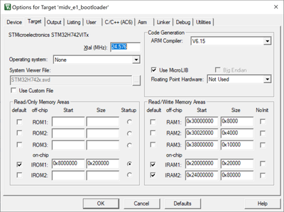

I'm having issues with software behaving inconsistently and freezing when I add certain lines, try to access certain variables, etc. I suspect maybe it has something to do with the restricted flash regions in the MCU. Is there any way around this? Can I "democratize" the whole flash and eliminate all of these restrictions somehow?
Here are my ROM/RAM settings in my project in Keil, if it is helpful for answering my question:
Thanks to anyone who can help make my project compile and run according to my actual code!
-Brian

I am referring to this in the reference manual:
"Flash memory enhanced protections, activated by option bytes
– Read protection (RDP), preventing unauthorized Flash memory dump to safeguard sensitive application code
– Write-protection of sectors (WRPS), available per bank (128 Kbyte sectors)
– Two proprietary code readout protection (PCROP) areas (one per user Flash bank). When enabled, this area is execute-only.
– Two secure-only areas (one per user Flash bank). When enabled this area is accessible only if the STM32 microcontroller operates in Secure access mode."
Maybe this doesn't apply to me since I didn't activate any option bytes...
I'm also a bit confused about where these RAM address settings come from in the project settings:
IRAM1: Start 0x20000000 Size 0x20000
IRAM2: Start 0x24000000 Size 0x80000
I meant maybe the MCU is sometimes trying to write/read RAM where it's not allowed?
Thanks!
-Brian

I am still having problems but I think the issue is with the way I've defined RAM locations:
There's a piece of code that is causing problems with overwriting RAM which was initialized in another function which should have been left untouched:

This is a really simple piece of code which just compares two fields of a structure with text constants. The __log() function outputs text to the UART and I can observe it on my PC terminal. This __log() function works when it is called before the first strncmp but when I try to call it after the strncmp() the whole program crashes (it doesn't output anything via the UART, even for __log() calls which happen before we get to this strncmp).
So I feel like I've defined the RAM areas incorrectly but I'm not sure how they should be defined...
The start address of AXI-SRAM memory is 0x2400 0000 and the size is 384 Kbytes which is 0x 60000 in keil. Please refer to DS12110 and precisely Memory mapping section.
Please let me know if the issue is solved.
Thank you.

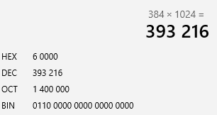

‎2023-12-21 4:58 AM - edited ‎2023-12-26 7:13 PM
OK wait a minute — isn’t 128kB actually 0x6000 and not 0x60000?
EDIT: Sorry, I was getting 0000 and 000 confused!
‎2023-12-21 5:33 AM
Hi @briankaz ,
128KBytes= 128x1024 Byte (decimal)= 0x20000 hex,
384 Kbytes=384x1024 Byte (decimal)=0x60000 hex
Thank you.
