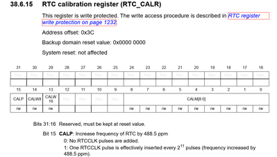

If you want "tune" the rtc, use :

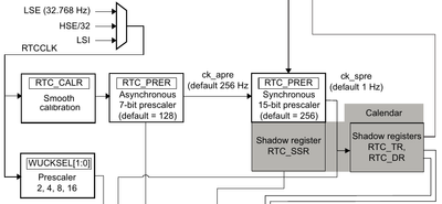

RTC does not work with "milliseconds", the "shift" feature works with the subseconds counter i.e. it "shifts" time by number of ticks (periods) of the asynchronous prescaler's output.
