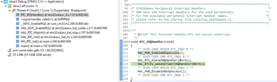

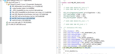

I'm working on a NUCLEO board (stm32wba52cg) and currently testing some of the baord's features, but i'm facing a strange problem with RTC. Problem is that the Interrupt of the wakeupTimer start firing immediatly after its initialization, then the program get stuck in a loop of infinite RTC IRQs (see the atteached screenshots):

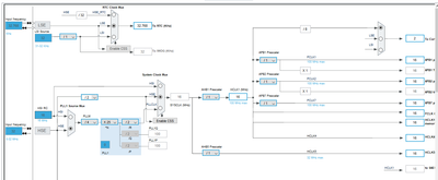

I am using LSE for rtc clock:
if i try to disable the irqs then the interrupt fires again on __enable_irq()

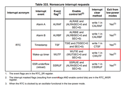

Also, I join you the RTC interrupts array in RM0493.
For the timer peripherals in their default configuration, the prescaler and counter are "pre-loaded" via a shadow register, which means that when you write new prescaler and auto-reload values (PSC and ARR) the new values do not take effect until the next "update event". (See page 1043 of RM)
