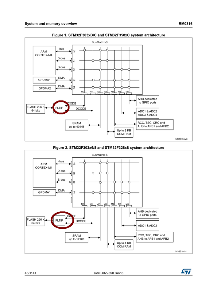

RM0316 - typo in figure (FLITF)
waclawek.jan
It should be FLITF.
It's also in the 3rd figure on the next page.
The typo is also in RM0364, but it's corrected in RM0313.
Can't these figures be redrawn so that masters are on top, and slaves on right, as is in other 'Fx RMs?

Hello Jan,
Thank you for highlighting the typo.
This is raised internally for correction.

The same typo goes across 'F3 manuals - RM0365 Fig.1-3, RM0366 Fig.1; also in AN4228 Fig.1 and AN4296 Fig.1.
Thank you @waclawek.jan for rising this up.
I escalated this typo to the appropriate team for correction in the coming releases (in the internal ticket ID162132).
Thanks again for helping us improve the ST documentations!
