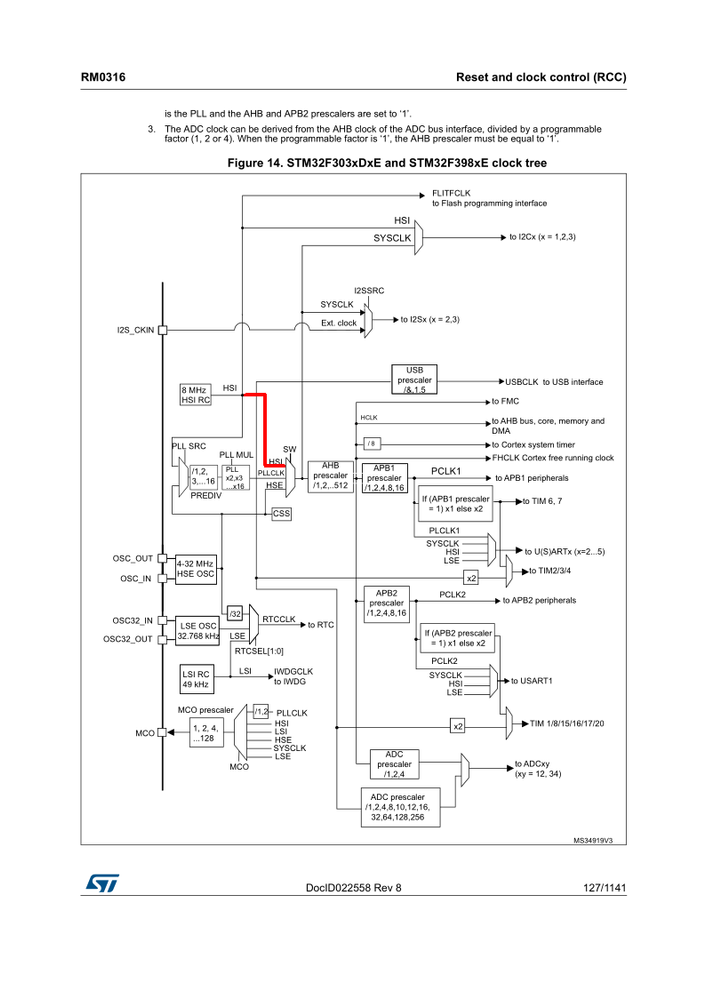

RM0316 rev.8 - Line missing in Figure 14. STM32F303xDxE and STM32F398xE clock tree

Hello Jan,
Thanks for highlighting this typo. I will report it internally for correction.
