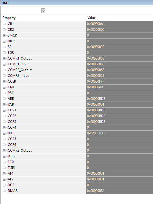

I'm using an STM32G431 using differential outputs on channel 1. On the scope, my deadtime is set where the channels overlap instead of having deadtime:
channel1
___-------___
------__-------
 channel1_n
How can I reverse the direction of the deadtime?

Did you measure those waveforms directly at the mcu pins?
Read out and check/post the timer registers' content.
eRuss.1
Here are the timer registers:
I have managed to change the symptoms by switching the polarity of:
sConfigOC.OCPolarity = TIM_OCPOLARITY_LOW;
sConfigOC.OCNPolarity = TIM_OCNPOLARITY_LOW;
This does not fully solve my issue though, because in this case, the PWMs have reverse polarity.
waclawek.jan
I don't quite know what do you mean by this, but try using PWM2 mode instead of PWM1.
This works great! Switching both OCPolarity, OCNPolarity and TIM_OCMODE_PWM1 did what I needed. Thank you!
