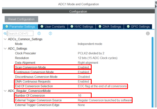

First of all, check you have enabled each channel.
Then, go to Parameters Settings tab and check that your configuration is the same as below:

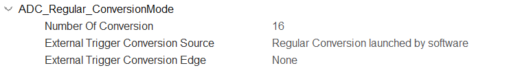

Then, after it should appear 16 Rank sections, for each of them, select the input channel and the Sampling Time. If you decide to not choose a specific Sampling Time, 3 Cycles option is selected.

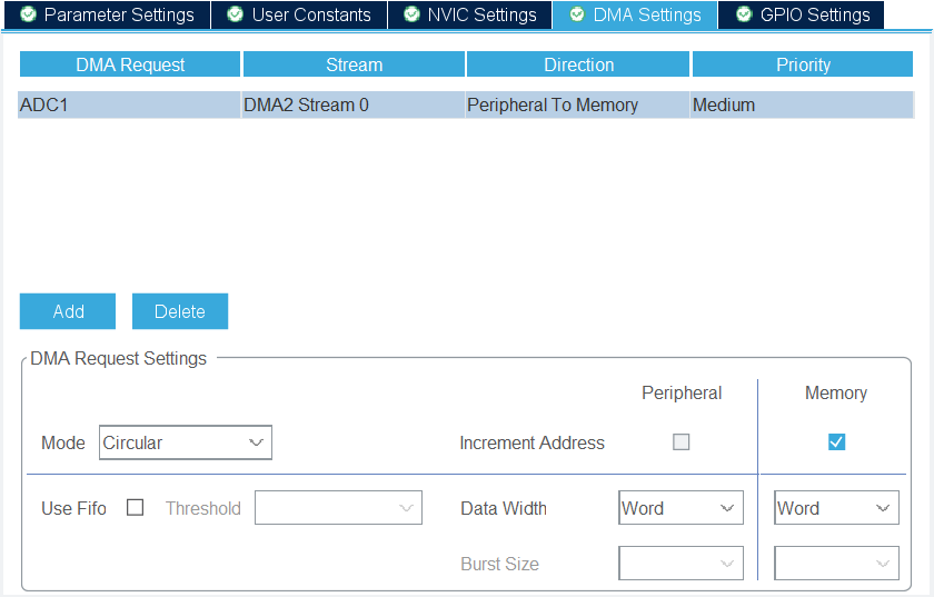

Go on DMA Settings tab (always in ADC1 parameters) and click on add button. As you want to convert in continuous mode, DMA will work as a circular buffer so select Mode Circular. The Addresses of your memory need to be increment automatically to fill your array. For that enables Memory Increment Address by checking the box and your data width will be a Word (or half-word 16-bit if you want).
Now your ADC and DMA are correctly configured. Now it's required to add some lines of code to start ADC and DMA.

The first parameter is your ADC Instance followed by your array name and the last is the size of the array. Calling this function will start converting is continuous mode and DMA will transfer each conversion result from ADC->DR register to your array and will loop each 16 conversions.
To check if it's working, enter in debug mode and add your ADC1_Results array in Live Expressions tab. You will see that ADC and DMA working continuously and each element of your array is corresponding to one channel conversion.
Please let me know if it's working on your side.
