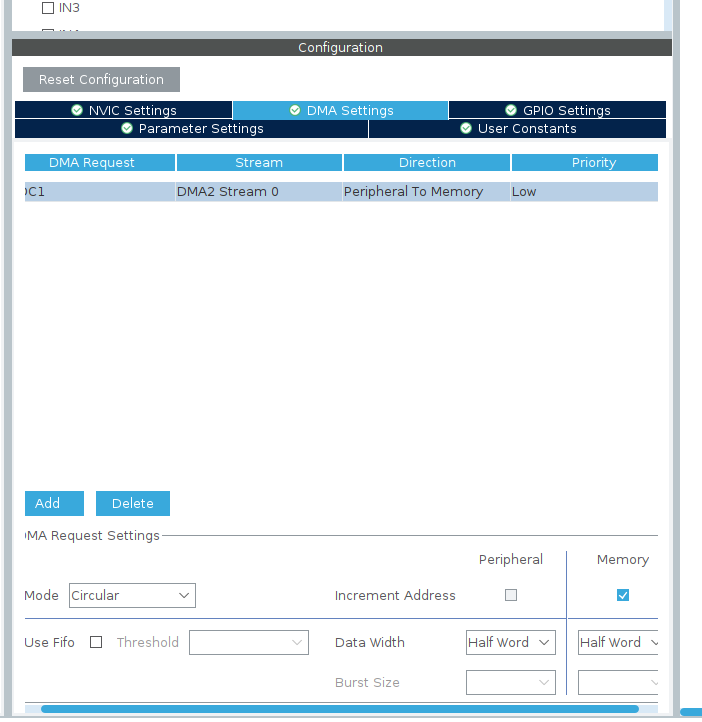

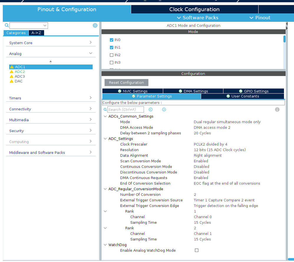

Config:

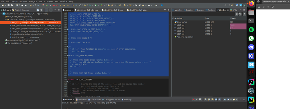

I can confirm that Callback is being called on ever Timer1CC2 event but only 2 out of 4 values get filled:
Any help is more than welcome:)
Data width should be word, not half-word.
richi
Ohh thank you so much, this resolved my issue.
Quick note: I am unable to change it in CubeMX I have only Half-Word option, so I did it manually. I don't know if this is a bug or what.
Many thanks:))

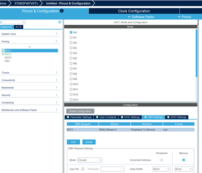

No problems changing it to Word in STM32CubeMX here.
