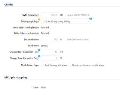

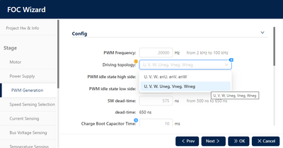

Can I get true 6-PWM (TIM1 CHx + CHxN) working on the X-NUCLEO-IHM16M1 (STSPIN830)?
Jeffrey1
I’m using the X-NUCLEO-IHM16M1 BLDC driver board, which is based on the STSPIN830, together with a NUCLEO-F446RE. In the STSPIN830 datasheet, ST clearly mentions that the device supports both 3-PWM and 6-PWM input modes.
But in practice, on this expansion board:
  • Only INU / INV / INW are connected to the MCU
  • ENU/ENV/ENW are present but “NP” (Not Populated) unless manually soldered
  • None of the INxH / INxL pins (the 6-input mode pins) are routed to the Nucleo connectors
  • TIM1 complementary outputs (CH1N/CH2N/CH3N) have nowhere to go
  • Motor Control Workbench only allows 3-PWM mode for this board
The user manual (UM2415) seems to confirm that the 6-input mode requires hardware changes: removing R12, replacing R11, and populating the NP resistors that route INxH/INxL to the MCU. Out of the box, the board is locked to 3-PWM “direct driving” mode.
My question:
Has anyone actually gotten TRUE 6-PWM complementary drive (TIM1 CHx + CHxN with dead-time) working on the X-NUCLEO-IHM16M1?
Not "6 logic inputs", but actual complementary PWM pairs like you’d use for a 3-phase inverter.
If yes:
  • Which resistors/jumpers did you solder?
  • Which pins did you remap on the Nucleo?
  • Did you modify the board to expose INxH/INxL?
  • Does MCSDK support this configuration at all, or do I need to go full custom firmware?
  • And is the internal interlock/deadtime in STSPIN830 going to interfere with MCU-generated complementary PWM?
If this is fundamentally impossible due to how the board is routed, I’d like to confirm that too before I switch to a different driver (DRV8303/8353, IR2101, L6386, etc.).
Anyone who has tried this, please let me know — ST’s documentation is a bit confusing here!
Hello @Jeffrey1,
We are facing an issue on our side on sharing file process.
Create a X-NUCLEO-IHM16M1_HL.json file into the ~user_name\.st_workbench\hardware\board\power directory with following content:

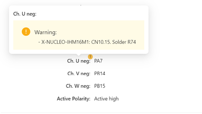

              "type": "DrivingHighAndLowSides",
              "help": "Remove R12 resistor. Set R11 to 0ohm.",
              "cost": 10,
              "signals": {
                "PWM_CHU_H": [
                    "name": "MR23",
                    "help": "CN10.23. Factory default",
                    "cost": 0
                "PWM_CHV_H": [
                    "name": "MR21",
                    "help": "CN10.21. Factory default",
                    "cost": 0
                "PWM_CHW_H": [
                    "name": "MR33",
                    "help": "CN10.33. Factory default",
                    "cost": 0
                "PWM_CHU_L": [
                    "name": "MR30",
                    "help": "CN10.30. Factory Default",
                    "cost": 0
                    "name": "MR15",
                    "help": "X-NUCLEO-IHM16M1: CN10.15. Solder R74",
                    "cost": 10
                    "name": "MR11",
                    "help": "X-NUCLEO-IHM16M1: CN10.11. Solder R79",
                    "cost": 10
                "PWM_CHV_L": [
                    "name": "MR28",
                    "help": "CN10.28. Factory default",
                    "cost": 0
                    "name": "MR15",
                    "help": "X-NUCLEO-IHM16M1: CN10.13. Solder R78",
                    "cost": 10
                "PWM_CHW_L": [
                    "name": "MR26",
                    "help": "CN10.26. Factory default",
                    "cost": 0
                    "name": "MR15",
                    "help": "X-NUCLEO-IHM16M1: CN10.15. Solder R69",
                    "cost": 10
              "highSideSwitchesDrivingPolarity": "Active high",
              "lowSideSwitchesDrivingPolarity": "Active high",
              "deadTime": 650

Hello @Jeffrey1,
The "DrivingHighAndLowSides" hardware variant was missing in the PhaseVoltageGeneration section of the X-NUCLEO-IHM16M1.json description file.
Find an updated version of the json file in the attachment. As mentioned in the IHM16 user manual: remove the R12 resistor, replace the R11 resistor with a 0 Ω resistor.
Add the X-NUCLEO-IHM16M1_HL.json file to the ~user_name\.st_workbench\hardware\board\power directory. Launch MC Workbench, the X-NUCLEO-IHM16M1_HL power board should be available and set.
If you agree with the answer, please accept it by clicking on 'Accept as solution'.
Best regards.
GMA

Hello @Jeffrey1,

Hello @GMA
Thank you for your support
I am able to see the 6PWM enabled
After enabling that Software asked me to solder R74, I hope this is expected ?

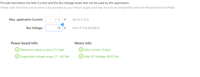

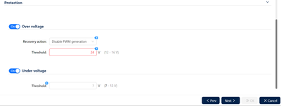

Finally I have one more doubt before closing this,
As per the datasheet this board can handle 7-45v, but my bus protection is set to 7-16v if I am trying to change it it's not allowing me. Kindly let me know how to work around this.
Best Regards
Jeffrey J
Try changing the json file Maximum rated voltage from 45 to 16.
maxRatedVoltage": 45
with
maxRatedVoltage": 16
and verify if it is reflected in your overvoltage protection.
The correct option is change in
section of MCSDK the value you require.
Hello @Jeffrey1,
In the X-NUCLEO-IHM16M1 single-shunt use case (note that the 3-shunt use case is not compatible with the NUCLEO-F446RE board), the R74 resistor must be added to connect MCU pin PA7.
The voltage limitation is determined by the maximum DC voltage setting of the motor.

 Hello @GMA
- so if my understanding is correct, I won't be able to do 6 PWM control using F446RE?
Or
- if I add R74 resistor then I'll be able to do 6 PWM control? (let me know what value of resistance)
