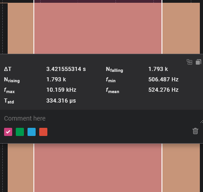

I am using stm32f769 controller. I am using timer 1 channel 4 for pwm output, and my APB1 clock is 180MHZ here I am taking prescaler : 17999 and ARR=1999 and ccr=1000 for this values I can see output of pwm by generating 5hz pulses. But when I want to generate 486 pulses where my psc:17999 , ARR=19, ccr=10, I cant see any output pulses, my pwm is not responding.

for lower frequency pwm is generating the required pulses which i can observe using captures when the frequency is getting increased I am not getting capture interrupt.

I attempted to replicate your case and honestly, I did not encounter the issue you described.
I set PSC to 17999 and ARR to 19, and I obtained a 500 Hz signal, which is the expected result for this configuration, not 486 Hz.
I can attach the project if you want to test it.
You can track the PWM signal from PA11 by using a logic analyzer or an oscilloscope.
If the problem still persists on your side, try configuring PSC to 999 and ARR to 369.
With a 180 MHz frequency, this combination also produces a 486 Hz signal.
BR
Gyessine
2026-02-03 2:37 AM
If I understand correctly, you are not monitoring the timer output with an oscilloscope, but are using another timer for this purpose. It is very likely that the error lies in the way you are detecting the timer output.
Check the timer output with an oscilloscope.
If you do not have one, you can also check it with a simple low-pass filter (RC circuit) with a multimeter at the output.
Another option is to set the DBG_TIM1_STOP bit in the DBGMCU_APB2_FZ register, which will ensure that the timer does not run when the program is paused. When you run and pause the program in the debugger and monitor the ODR or IDR register of your port, you can see if the state of the pin changes.
