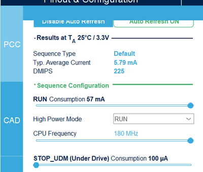

USB HS is used as MSC with external PHY is running ok. Want is to reduce power, by trying low-power code gets stuck and I need help on enabling same?

Hello @FBL ,
Thanks for replying, the changing unused IOs to analog option got me into a issue, where by Im not able to re-program the controller F429 custom board, the debugger refuses to identify the controller, causing unable to change the program.
also I tried reducing cpu clock to 90 mhz
I tried checking swd lines and boot0 and boot1 lines, looked ok to me.
would appreciate a quick response, since a controller is un-usable.
