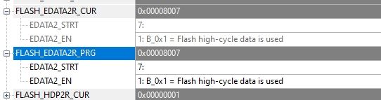

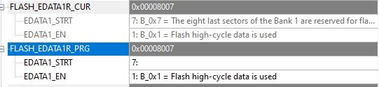

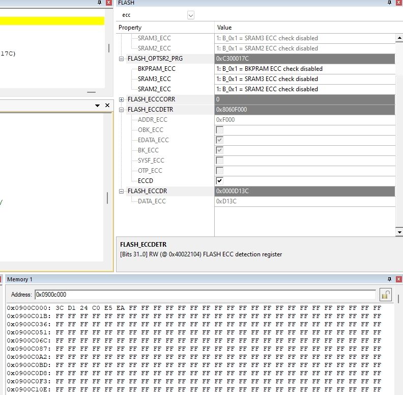

Hello,Sir,
I configed these registers,you can see that abrove.But when I read 0x0900C000,there's something wrong with it,you can see status of ECC at first picture.

Hello again @Shiro,
There is an an ECC error indicated by the FLASH_ECCDETR register, the data at 0x0900C000 is corrupted, this makes me think that the write wasn't ok, it may be incomplete or interrupted..
On my side, starting from the same project and changing the base address to 0x0900C000 does not generate an NMI, are there any other changes you made?

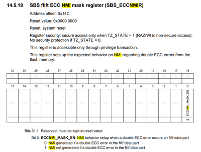

‎2024-10-23 8:57 AM
When the ECCD the flag is raised, an NMI is generated, it can be masked in SBS registers (SBS flift ECC NMI mask register (SBS_ECCNMIR)) for data access (OTP, data area, RO data)
You can mask the NMI by this setting this register, however, we have to determine the cause of corruption, will you be able to share a project to reproduce?

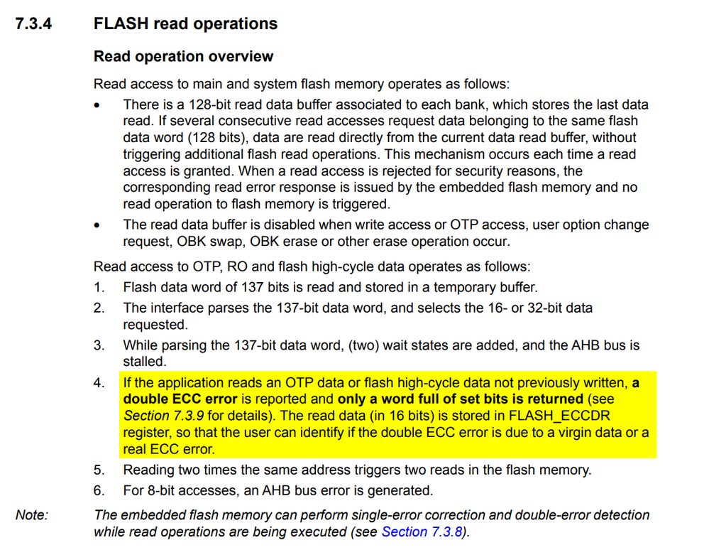

‎2024-11-12 5:12 AM
Hello @Shiro,
>>The correct process is,Init ->Erase->Program->Read.
But Init->Erase->Read it'll report error.
Yes! According to RM:

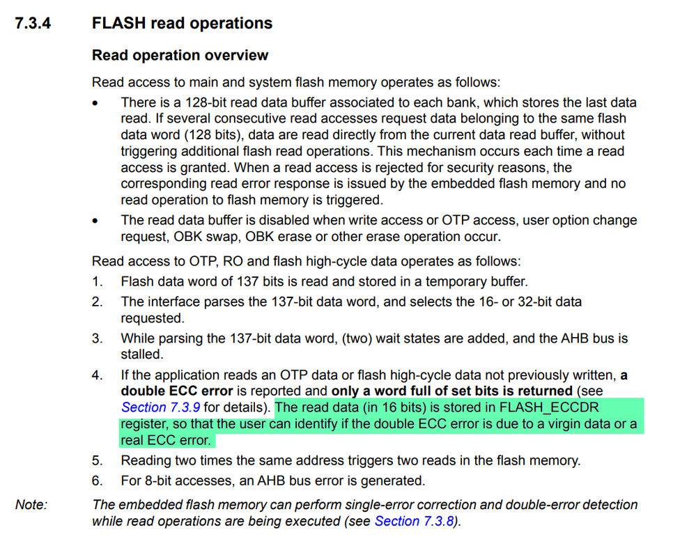

So yes, the high cycle data area should be written before read!
You can handle it in the NMI interruptions so that when it triggers, you can make an exception for that use case, reset flags and go back to the code, you can use this part of the RM (in green)
to create the exception:
