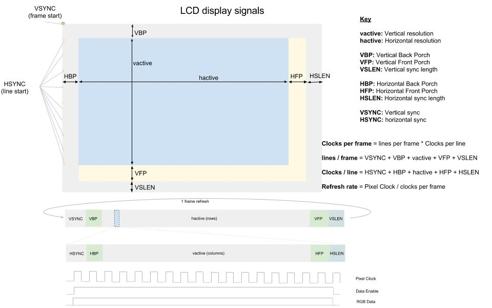

I'm using an STM32H7S78-DK with TouchGFX and FreeRTOS. I would like to limit the framerate of the target to 30fps but withouth reducing the LTDC frequency.
Basically having the VSYNC fired at 30fps

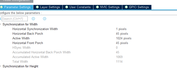

You can increase the front and back porches in your LTDC.
This way you use more clock cycles per frame so your frame rate drops.

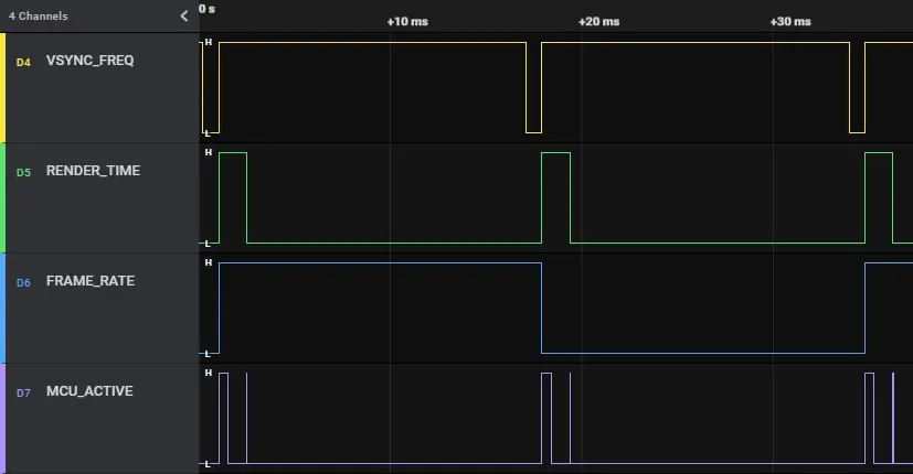

Thanks a lot for the answer. My goal in reducing the refresh rate was to save CPU cycles for other operations; with the approach you propose, it feels like I'm just burning CPU cycles to drop the FPS, without really removing work to process the frame, or am I wrong?
Studying a bit, I've found out that another way is to use a custom timer set to 30Hz and toggle the VSYNC pin, but I think that's way more tricky than changing parameters in CubeMX

 The CPU is not busy waiting (blocking) for LTDC interrupts. You'll actually get more idle time per frame.
https://support.touchgfx.com/docs/development/touchgfx-hal-development/scenarios/scenarios-measure-performance#performance-metrics
