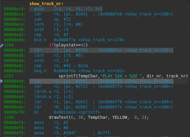

0693W00000aHd6uQAC.pngand then this breakpoint seems never reached, but when going step by step
0693W00000aHd4wQAC.pngline 1354 is reached and also the following "sprintf.." , but it gets curious:
when "Radio.." text is selected , is drawn on TFT and program runs on,
but when"PLAY..." is selected, it never prints and "hang up" in some loop around DMA-INT-busy-ready-DMA...endless. but no hard-fault coming, just busy looping.

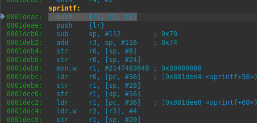

just...this is the asm here:

if stepping in the print-to-TFT :
0693W00000aHedfQAC.pngbut is there:
0693W00000aHedpQAC.pngI am at a loss.
