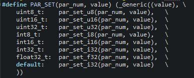

I am facing an issue with the STM32CubeIDE V1.17.0 indexer, where it highlights a syntax error when using the C11 _Generic primitive. Due to company project policies, I cannot upgrade to a newer version of the IDE at this time, so I need to find a solution or workaround for V1.17.0.
The indexer flags the code as a "Syntax error" as shown in the attached image:
The PAR_SET macro is defined as follows:
Key details:
  • There are no missing includes or path issues.
  • The code compiles successfully without any errors or warnings (GCC is happy).
  • Runtime performance is intact, and the macro functions exactly as expected.
The problem seems to be strictly with the indexer being unable to parse the C11 _Generic keyword correctly. Has anyone encountered this or found a way to "hint" the correct syntax to the indexer?
Any suggestions are greatly appreciated!
Best regards, Žiga

@CTapp.1 wrote:
Probably the same underlying issue as reported here and here
Indeed!
@CTapp.1 wrote:
basically seems to be a known Eclipse issue related to C11 language features.
although the 2nd one isn't to do with C11 - it's GCC-specific "attribute" stuff.
Another one here - with C23
@zmiga in conclusion, this is a known "feature" of the Eclipse syntax analyser.
And it's not unique to Eclipse - other IDEs (eg, MSVC) also have similar "features" with their syntax analysers.

Probably the same underlying issue as reported here and here - basically seems to be a known Eclipse issue related to C11 language features.
