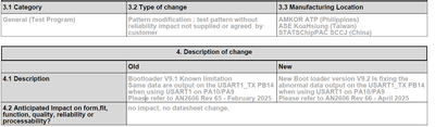

Process Change Information (STM32H74x/75x - Microcontroller product - Bootloader enhancement)
richaverma
Visitor
We are using STM32H743 Controller in one of our LRU (Line replaceable unit).
Since February end, The LRU System Test equipment cannot load the programming (.bin ) file to many units. This is the first time this specific failure mode has appeared. This is also the first time that any kind of OPS programming failure has appeared that isn't an operator or facility issue.
We have tried loading the  .bin file using STM32Cube programmer as well but still the issue exists.
We have recently come across this PCN where Bootloader version of 9.1 is Changed to V9.2 resolving abnormal data output on the USART1_TX PB14.
  1. We are using USART3_TX on PB14 and USART3_RX on PB11.  Do you think OPC bootloader V9.1 to V9.2 has any impact on USART 3 interface used for RS-232 ?
Note , once we replace the STM32 IC with the old batch code , this issue is resolved.
More details :Here are our connections.
USART1_TX : PB14 (PULL DOWN 100K), series resistor 47 ohms.
USART1_RX :PB15  (PULL DOWN 100K ) series resistor 22 ohms .
USART1 connections are currently not used but has the above connections available in the design. Do you suggest removing the pull-down resistor of 100K  when USART1 is not used?
We are using USART3 for programming using serial port.
Connections:USART3_RX : on PB11 and USART3_TX on PB10 .
None of them have a pull up currently. Used RS232 driver MAX3232MPW. Do you suggest the pull up resistors on these Tx and Rx lines?
Can we get the bootloader code for 9.1 and 9.2?
Is anyone else has faced similar issues in the past ?
Request you to please provide some support as this is our production issue and needs to be resolved immediately.
Amel NASRI
Hi @richaverma ,
Welcome to our Community!
First recommendation I share is to check the bootloader version for both batch of devices.
Depending on the bootloader version, you may confirm or discard some assumptions.
Your reference is AN2606: depending on the version, please check the table "Table 124. STM32H74xxx/75xxx bootloader version" for the known limitations (mainly what is related to USART1 pins in your case).
Please keep me informed about the outcomes of your checks.
-Amel
What does this mean? How do you "load" the bin, exactly, and what are the symptoms of the failure?
How do we get the details of Bootloader version ? I am attaching the snapshot of Good versus Bad STM32H743 . This is loaded already when we buy the part. is there a way to find the bootloader configuration from the Manufacturer part number?
i have attached some initial picture of the good versus bad. More to get from production . Also i have attached the log file which shows some details of error. The bootloader is already loaded from factory . is there a way to find which bootloader is incorporated just by knowing the manufacturer part number.
Yes through JTAG when we load the .bin file it works fine.

It think AN2606 provides a location to check version#. Log suggests "3.1"
Both these images seem to depict a part from the exact same production batch, so I doubt they have different Boot Loader versions. Perhaps look for other reasons the programming fails, like noise of other UARTs, or communications failing on the one you're using.
Connectivity here is a one-shot deal, the System Boot Loader might function differently is the FLASH is blank, vs not.
The BOOT0 pin needs to be pulled-high, and a Reset / Power Cycle needed to enter.
On might also look at AN3155, and perhaps walk the devices through initial start sequence and query of command list, etc.  One can use RealTerm in HEX mode to interact.
Other issues potentially : Power, VCAP capacitors/voltages, External Crystal (More USB related)
Perhaps build a test application you load via JTAG/SWD to probe/test part/board functionality, and stress test.
Usually a cross-over date is provided in related PCN, and ST can likely trace data to a production batch
