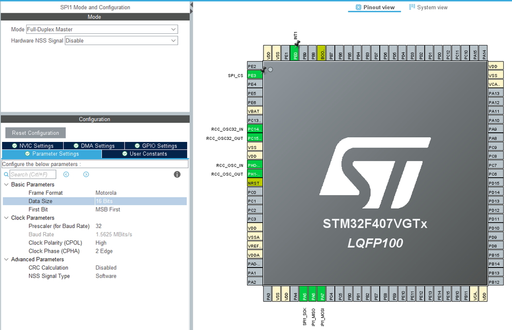

Hi!
So I configured my SPI to work with DMA and with external CS. Before my main loop I set CS high, and everytime before I initialize communication on SPI with DMA i set CS low. Then, after communication is done I go to interrupt on that event and set CS high again (don't know if it is the best way on doing that, let me know if there is one better :) ).
Okay, so in while(1) loop I transmit-receive data from LIS3DSH. I sent 3 commands and receive 3 sets of data. The trick is that it's working really strange.
So, when I'm sending WHO_AM_I (0x8F) I should receive 0x3F, but whoami value is 0x00.
When I'm sending INFO_1 (0x8D) I should receive 0x21, but info1 value is 0x3F.
And when I'm sending INFO_2 (0x8E) I should receive 0x00, but info2 value is 0x21.
I check tx-rx on oscilloscope, and communication looks perfect, just the values of my variables are weird.

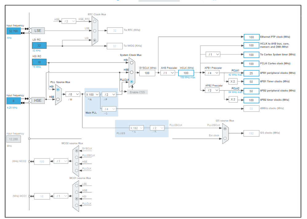

I know that using DMA on SPI causes it go on full speed, maybe I'm just too fast and my variables are changing too slow? I'm not sure.
Here is my code and configuration in CubeMX.
