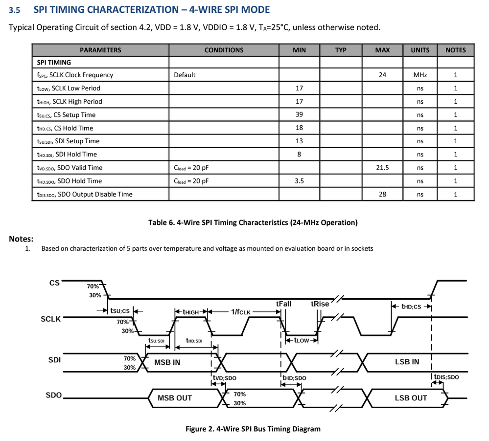

The ICM-42688 Timing data is:
 So CPOL = 1, CPHA = 2 and SCLK ic high in idle.
(I have also tried CPOL = 1 and CPHA = 1  which also delivers an identical result)

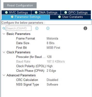

The Device Config is as follows:
hspi1.Instance = SPI1;
hspi1.Init.Mode = SPI_MODE_MASTER;
hspi1.Init.Direction = SPI_DIRECTION_2LINES;
hspi1.Init.DataSize = SPI_DATASIZE_8BIT;
hspi1.Init.CLKPolarity = SPI_POLARITY_HIGH;
hspi1.Init.CLKPhase = SPI_PHASE_2EDGE;
hspi1.Init.NSS = SPI_NSS_SOFT;
hspi1.Init.BaudRatePrescaler = SPI_BAUDRATEPRESCALER_128;
hspi1.Init.FirstBit = SPI_FIRSTBIT_MSB;
hspi1.Init.TIMode = SPI_TIMODE_DISABLE;
hspi1.Init.CRCCalculation = SPI_CRCCALCULATION_DISABLE;
hspi1.Init.CRCPolynomial = 10;
I have it slowed down at present to see if speed is the cause of my problems...

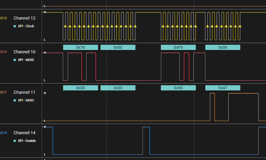

When I monitor the lines with my Saleae 16 I get a good response.
The 0x76,00 is a write to the register 0x76 to select bank 0.
The 0xF5,00 is a read request for the Register 0x75 and it should return 0x47 which is is doing - YAY.
My problem is that the data doesnt seem to be clocked into the STM32F413 chip...
I always end up with 0x00.

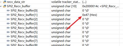

Spi_TransmitReceive , you have to fill with the register value and then dummy bytes of zero to clock out the data. For example
rx[0] = 0x75; rx[1] = 0  till the len count.
FYI. As per datasheet, the first bit should be 1 for read and 0 for write. So you can try eith 0xF5
