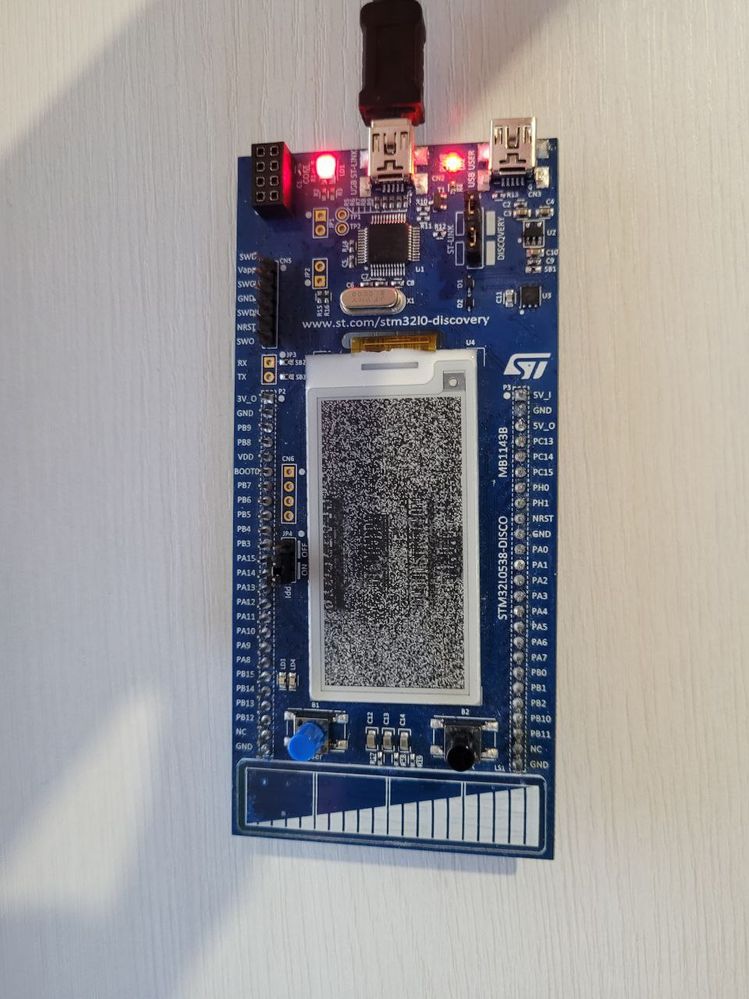

I have an STM32L0538 discovery board and I'm trying the Demo example. The problem is that it does not work. When I flash the board it changes the e-ink display like this:
Also when I touch the bottom bar it does nothing. The revision of the board is Rev-B03.

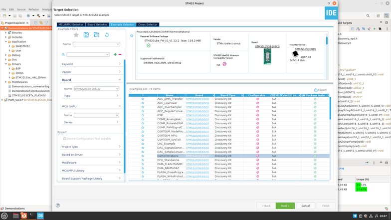

I use the example from the STM32CubeIDE:
I need to change something in the project??? Because seems like it works partially.

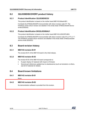

Hi @waclawek.jan ,
The demonstration is not supported with MB1143 revision B-03 revision board.
I escalated this request internally.

Yes, is the MB1143! Thank you very much! I am realizing that I have to look more closely al the user manual.
‎2023-08-17 11:17 AM
> MB1143
The difference is in the revision, the older one for which the demo works, is MB1143-B01, yours is MB1143-B03. You can find this printed on a label at the bottom side of PCB.
