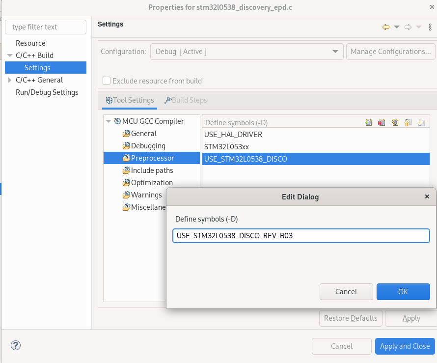

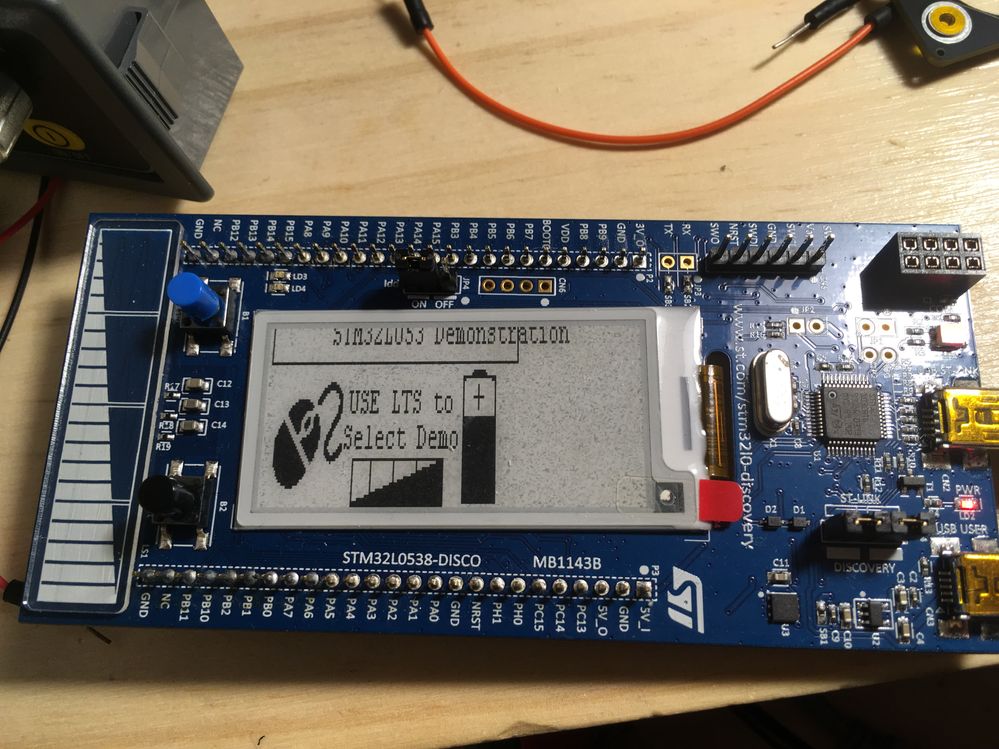

‎2023-01-06 3:15 AM
I finally got the demo program running on a RevB03 board. :rocket:
Sharing this for my future self or for others in the same situation:
- Clone the repo linked by @Walid ZRELLI​ : https://github.com/STMicroelectronics/STM32CubeL0.git
- From the root of that repo: cp -r ./Drivers/BSP/Components/gdem0213b74 ./Projects/32L0538DISCOVERY/Demonstrations/SW4STM32/STM32L0538-Discovery/Drivers/BSP
- From STM32CubeIDE, open project ./Projects/32L0538DISCOVERY/Demonstrations/SW4STM32/STM32L0538-Discovery
- Right click project -> Properties -> C/C++ Build -> Settings -> GCC Compiler -> Preprocessor Change USE_STM32L0538_DISCO to USE_STM32L0538_DISCO_REV_B03
5. Build and flash
The dimensions of this display must be different from the original, because the GUI looks truncated but otherwise it works as documented in the readme.txt

I have managed to compile and load the demo project, both with the Cube and Keil. The result is the same, the two leds blink, the screen shows nothing and the buttons and the touch do not react.
