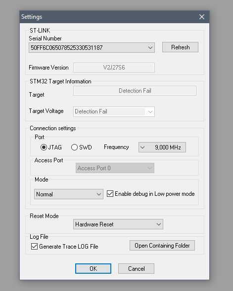

I use the STLINK with this settings :
i use this STM32 ST-LINK utillity

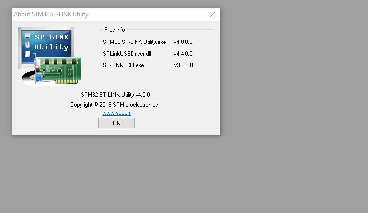

The ST-LINK Utilities have also been deprecated in favour of STM32 Cube Programmer
I think this is a pity, but nevertheless it is the state of affairs.
