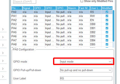

Hi everyone I'm rather new with programming with STM32 controllers and I am currently using NUCLEO-L432KC. Currently I'm facing a problem with HAL_GPIO_WritePin() function. I am interfacing with a 16x2 LCD and I am trying to write to the RS pin via the function I have mentioned, however I am facing a problem where the RS isn't being set to the desired value I am providing. I have provided the value like so: HAL_GPIO_WritePin(RS_GPIO_Port, RS_Pin, rs);
Where I have given rs = 0 but the function is setting the value as 1. I have also provided the photo of the RS pin configuration from the IOC file.
Hi
from your ioc file
PA0.GPIOParameters=GPIO_Label
PA0.GPIO_Label=RS
PA0.Locked=true
PA0.Signal=GPIO_Input
You see the Error? "GPIO_Input"?

Andrew Neil
Welcome to the forum!
Do you have experience with any other microcontroller(s)? With programming in general ?
Please post your source code - instructions here:
https://community.st.com/t5/community-guidelines/how-to-write-your-question-to-maximize-your-chances-to-find-a/ta-p/575228
Also your schematic of how the LCD is connected.
A good, clear photo may also help.
Have you checked the Nucleo board's User Manual and/or schematics to see that nothing else is using that pin?

I have also tried the same thing by substituting rs as GPIO_PIN_RESET but the same issue occurs
No problem, I have provided my ioc file as requested to help you get a better understanding of my configuration
I am actually passing rs as an argument from a function call as shown so I'm not sure if this also causes a problem. (Edit: I tried changing the type of argument for rs from int to GPIO_PinState: void send_cmd(char data, GPIO_PinState rs) but this also doesn't work and the same problem occurs.
send_cmd(0x38,0);
void send_cmd (char data, int rs)
Time to go back to basics.
Disconnect the LCD.
Go back to a basic "blinky" program which just toggles the LED on the Nucleo board - just a loop with inline delays.
Once that is working, change it to toggle your RS pin.
Does the pin toggle?
