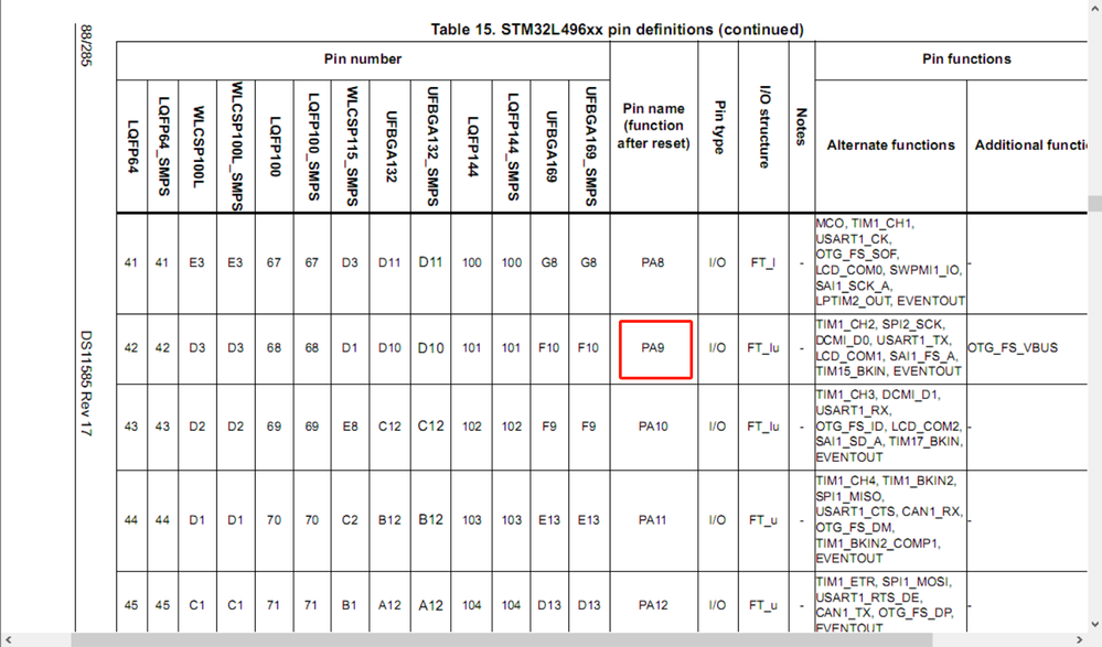

    I use STM32L496 on my board, and use PA9 as a GPIO for input, without any external resister.

    But, on the board, I measured PA9 has a high voltage level, but PA10 and PA11 is low. If do not call BSP_Init(), PA9 is high level,too. If a change GPIO_InitStruct.Pull to GPIO_PULLDOWN, the result is same as above. I checked the register, three pin has the same configure. And no other place configure these pin.
    Is there same mistake about my use? It's been bothering me for a long time. Does anyone provide any help, Thanks very much!

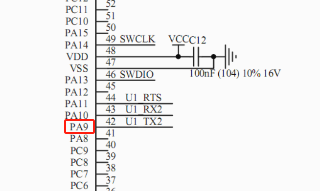

A) Show us all relevant schematic (U1 TX2)
B) Check PCB trace from shortcut to VCC
C) Explain how exactly did you measured "high level" on pin without pullup/down. It is little bit tricky to measure floating input !

In your schematics there is the signal called "U1 TX2". What kind of signal is this: input or output? The voltage you are measuring could be sourced by this signal.
Could you please share the schematics?

Thank you for reply.  "U1 TX2" is input, and it connect nothing. I will check carefully.
Thank you for reply.  I will check carefully according to your recommendation.
