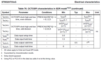

‎2024-08-13 3:41 AM
Check the datasheet not the RM, search for "PC2".
Datasheet of H733, should be the same for H723/H725.
See note 4.
Even worse, see again note 4 for HyperBus, max freq with PC2 is 47 MHz:
Dear ST, this should not be in smallest print in some footnotes, but bold and BIG in each mentioning of every use outside of analog input.
There was no CubeMX warning?

My five cents:
A GPIO output on MCU is for sure below 50 Ohms. But which exact value might depend on your drive strength settings. Also: using a "shared pin" like PC2_C (which has also an analog path inside MCU and an analog mux involved) might make it unpredictable about the "impedance". I would try to avoid using "muxed" signals (having an analog ALT feature in parallel, even not used but a circuit inside chip).
It is not just impedance: if you change your PCB from 6 to 4 layers: I would also consider these:
- have all the traces the same length? (length compensation, esp. if clock signal is shorter as data signals)
- is there enough ground shielding ("ground pour")?
- Could you have "cross talk" between QSPI signals (esp. clock and data signals) or "cross talk" from another high speed signal (e.g. an USB signal crossing or going along with QSPI signals, or signals going for a length in parallel with each other, with reduced clearance or missing ground separation)?
- Is there "noise" on the power rail? Decoupling not strong enough? Power traces too long, thin and in
"sequence"? (not a real grid) - backward current via GND is "noisy" (e.g. GND flow too long, blocked by other components on board)?
(often we forget to check the ground current current flow - same short paths on GND as on PWR)
- Do you have a scope screenshot for signals doing QSPI access?
(when do you see errors? - scope screenshot) - Did you do an "eye diagram" (with scope)?
- is it working if you lower the QSPI clock speed?
- have you tried to use the DLYB features? (and calibrating the timing)
BTW: 33R series termination is pretty common. But the rule is: such a 33R resistor should sit close to the driver output. But if you do a read: the 33R might sit on the "wrong end" (close to MCU, not on QSPI "outputs" during a read). So, these 33R are just a compromise. I would rather check for cross-talk, power rails, GND return flow and deblocking issue.
