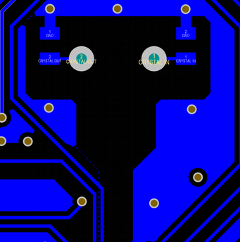

mƎALLEm
1- Please share your ioc file.
2- Need to post the part of schematics of HSE: crystal + load capacitors + the MCU.
3- If you toggle a pin with a specific delay lets' say 500ms or 1s and using HSE + the crystal, does it toggle with that delay value?

As both you and TDK suggested, I also suspect that the issue might be due to a hardware design problem with the external clock circuit.
Here are my .ioc file and the crystal design.
Thank you for all the help!

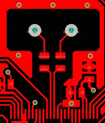

Dn1te
I used HSI to configure the clock to 520 MHz, and I set up TIM1 and assigned its counter value to a variable 'testcount' to track the clock frequency. Everything works perfectly in this case.
The only problem is that this setup works only when using HSI, but not when using HSE. When I switch to the external crystal (HSE), the clock frequency always stays fixed at 64 MHz, no matter how I change the configuration. The variable 'testcount' also always remains 0.
As both you and mƎALLEm suggested, I also suspect that the issue might be due to a hardware design problem with the external clock circuit.
Here are my crystal design.

Okay, so 20 pF load caps but crystal part number is not stated.
Guidelines for oscillator design on STM8AF/AL/S and STM32 MCUs/MPUs - Application note
Try smaller caps :
12 pF or so. check.

I found out why it didn’t work. Turns out the 0-ohm resistors weren’t soldered properly. Thank you all for the advice!
