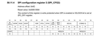

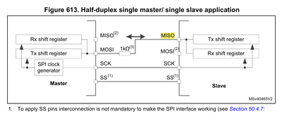

> In cube, the SDI pin is mapped to SPI2_MISO, PB14. But as a slave, shouldn't the correct SDI pin map to SPI2_MOSI, PB15?
A half duplex data connection on the slave side should be on the MISO pin, as shown in the reference manual.

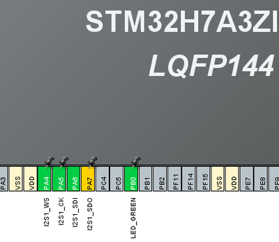

recepsah
This problem still persists for the STM32H7A3 in CubeMx v6.17. I worked around it by configuring the PA7 pin separately, but it’s not a clean solution.
