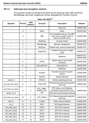

Where can i get the information about which interrupt is activated for each of those bits? How can such information be so hard to find? Cant find it on the ARM website! Just the information, that it shows activated interrupts, which is essentially useless... *facepalm*
Easier to get this information from the VECTACTIVE field in SCB->ICSR.
LSB of IABR0 corresponds to "NVIC position" 0 which is WWDG1 here. Goes up from there, 32 per register.
13 of them don't have "NVIC position" values because they're system interrupts and not reported anywhere in IABR.

I see 13 without a NVIC position. I still dont know which bit corresponds to which interrupt.
Enumerate the entire table..
That information helps. But its easier to add 16 to the NVIC postion?
The count without "NIVC position" is actually 16 like you said before. There is one row that includes more than one address.
VECTACTIVE does not correspond with the IABR.
What i get, is position 27 and 44 in IABR and 60 in VECTACTIVE?
It would make sense, if 16 is beeing subtracted from 60. Quite confusing. Why isnt there some better documentation? Or is there any?
I said 13 to make it simpler. You are correct that there are 16.
If bit 0 in IABR is set, that corresponds to VECTACTIVE=16.
If bit 27 is set, that is VECTACTIVE=43.
If bit 44 is set, that is VECTACTIVE=60.
