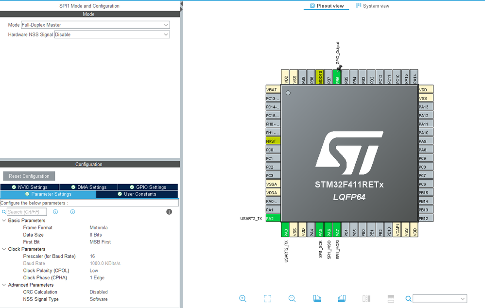

It seems that I'm having problems with the pins configured as alternate function.
If I configure the same pins used by SPI or USART as simple gpio outputs, I can see them toggling with the logic analyser. but when I configure them as SPI (alternate function) or USART they are not working as expected. I have tried changing SPI creating an stm32 project, configuring the pins through the GUI and using the HAL_APIs. the result is the same : I can see the pins toggle when configured as gpio outputs, I can't see anything when configured as SP or USART.

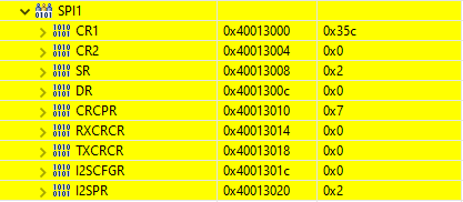

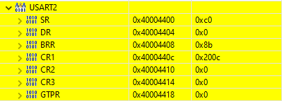

I have checked with the debug and the SPI and USART registers are configured as expected.
am I missing something?

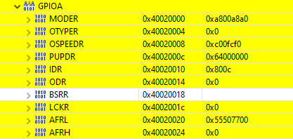

Post, together with the relevant GPIO registers content.

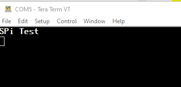

‎2021-06-23 2:58 PM
with the code above I connected TeraTerm using ST-Link virtual com. I can see the message displayed in the console:
but the logic analyser on pins PA2 and PA3 shows no traffic

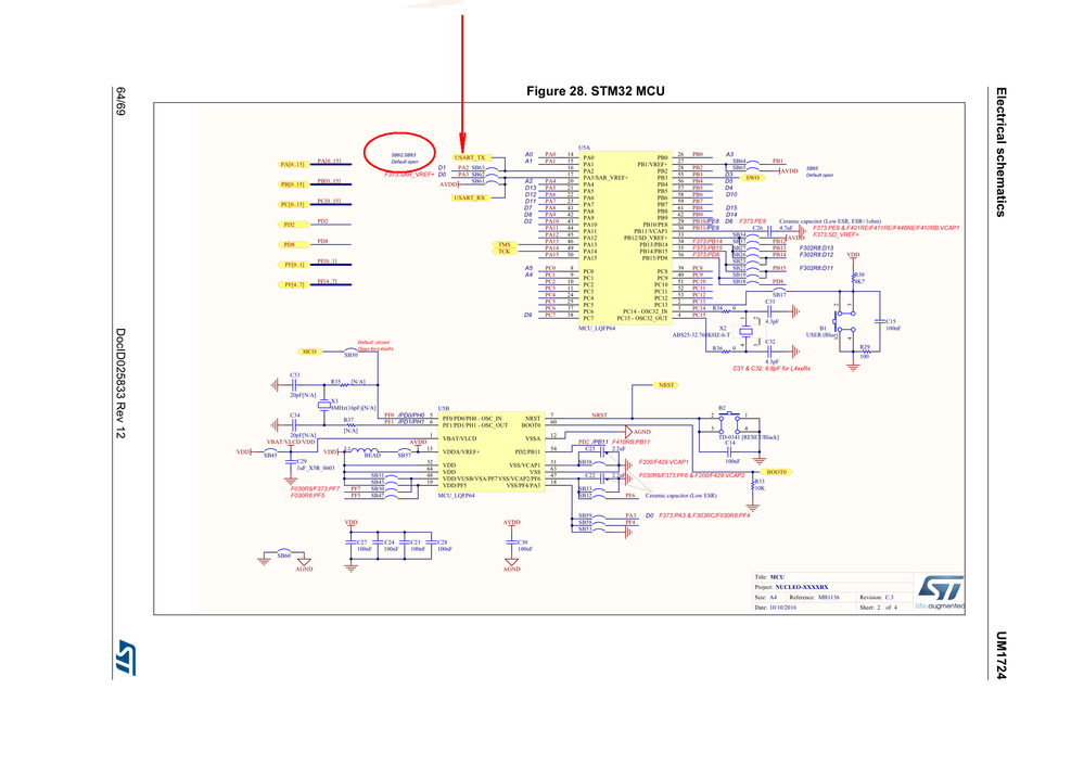

‎2021-06-23 3:06 PM
Then the logic analyzer is not connected to pins PA2 and PA3.
They may be brought out to the pinheaders through jumpers/solder bridges which are not connected by default.
‎2021-06-24 1:34 AM
I managed to make it work using USART1 on pins pa9 and pa10 and SP1 on pins pa5,pa6,pa7 and pb6 (/CS)
