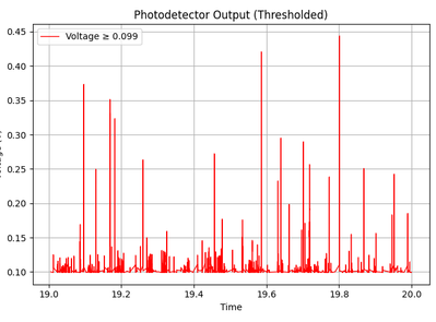

yes i need exact peak voltage.
There is no fixed difference between peaks.
I don't think a comparator will be useful?
No, not a comparator but peak detector with reset circuits. If pulses arrive not very often, than you don't need fast adc
peak detector with reset circuits - reset circuits?
pulses arrive in intervals of near 400ns - assumption
That is no easy task... any colleagues available with high-speed analog / ADC experience?
Bad luck, 400 nsec = 2.5 MSPS. Complexity of the peak detector at such high rate Is over using external fast adc.

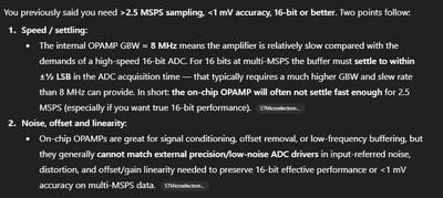

  This thread mentions ad7960, ad7983/ 84 - get data sheet and study drivers. Analog (ADI Corp.) also has evaluation boards for this adc, worse to look into.
In general, high speed, wide bandwidth and low distortion, most of this op amp intended for video application. Front page of the data sheet such op amp explicitly says "application: Precision SAR ADC drivers, or just ADC drivers".
In STM particular case, I'd recommend to use lmh6612.
3.3V limits pretty tough requirements in this domain, ada4899 and a lot others op amp are not good due +5-+12 V power range.
