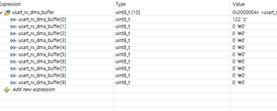

NUCLEO H563ZI USART GPDMA channel6 not received buffer.

usart_rx_dma_buffer
Only one comes into the buffer and the rest is not filled
please check config.

Additionally  when i test gpdma2 channel 0 it is working well.
Bue gpdma2 channel6 is not received buffer.
I  have to use gpdma channel 6 .
Can  you check please~
