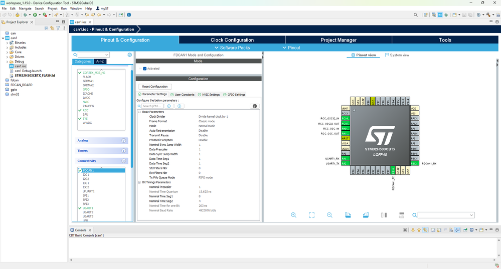

I am use nucleo-h503rb evk board and i am configure fdcan communication. I have mention below my code please see. I have did not comes output on FDCAN communication.

  2. now I have changes as per your guidence butissue has nor resolved hfdcan1.Init.NominalPrescaler = 1; hfdcan1.Init.NominalTimeSeg1 = 8; hfdcan1.Init.NominalTimeSeg2 = 4;
Need to describe your issue and answer all my questions/requests I asked/requested before.
Share also your ioc file.
PS: This is NOT an online support (https://ols.st.com) but a collaborative space. So please be polite in your reply. Otherwise, it will be reported as inappropriate and you will be permanently blacklisted from my help/support.
ekatpurerohan
Thank you. But again you didn't describe the issue. It's an issue on transmit/receive ??
You need to share also the schematics: how you did connect the transceiver? the terminating resistors? Did you connect another node on the bus?
Please answer all these questions in order to help you efficiently.
Also please check each point I raised in my previous comments. dropping some comments increases the ping pongs efficiently. For example In your ioc file Your clock source is set to HSI while in my previous comment I suggested to use HSE with an external precise crystal, did you do that?
