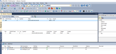

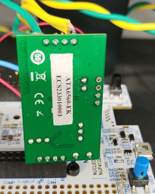

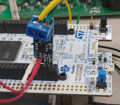

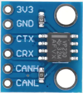

I am using CAN1 pins to Connect to the driver board (SN65HVD230).
 All Voltages are good.
I am using 2 PCAN dongles with 120 Ohm terminations at both ends of the BUS with the Nucleo CAN shown above in the middle of the bus.

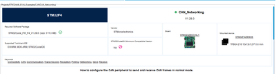

I ported the code from the following project;
>TX Mailbox used: 0x1
t
>TX Mailbox used: 0x2
s
>MCR: 0x30
Can State: 0x2
Interrupts: 0x1007F, msr flags: 0xC00 , tsr flags: 0x52000000, rf0r flags: 0x0, rf1r flags: 0x0, esr flags: 0x0
The Tx message is not getting out.
Also I have a PCAN message being transmitted on one PCAN dongle and the other PCAN Dongle is receiving the message fine.
The Nucleo pcb does not see the message at all.
I am using the default clock setup for the NUCLEO board

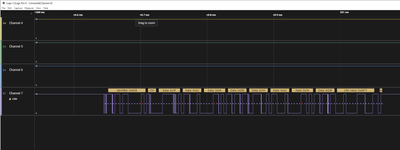

4- You need to validate your tranceiver module:
Are you seeing frames on CAN_TX and CAN_RX? If not, you have an issue with your module. Are you sure the transceiver is power supplied? check the voltage on its pins.

 I changed to different transceiver and fixed the Port Pin selection on the CAN_TX and CAN_RX. I had Pin 0 and Pin 1 configured to the alternate selection but it was on port G instead of port D. I also had the CAN_H and CAN_L swapped. I am now working great. Thanks SoftLit and Karl for your help.
